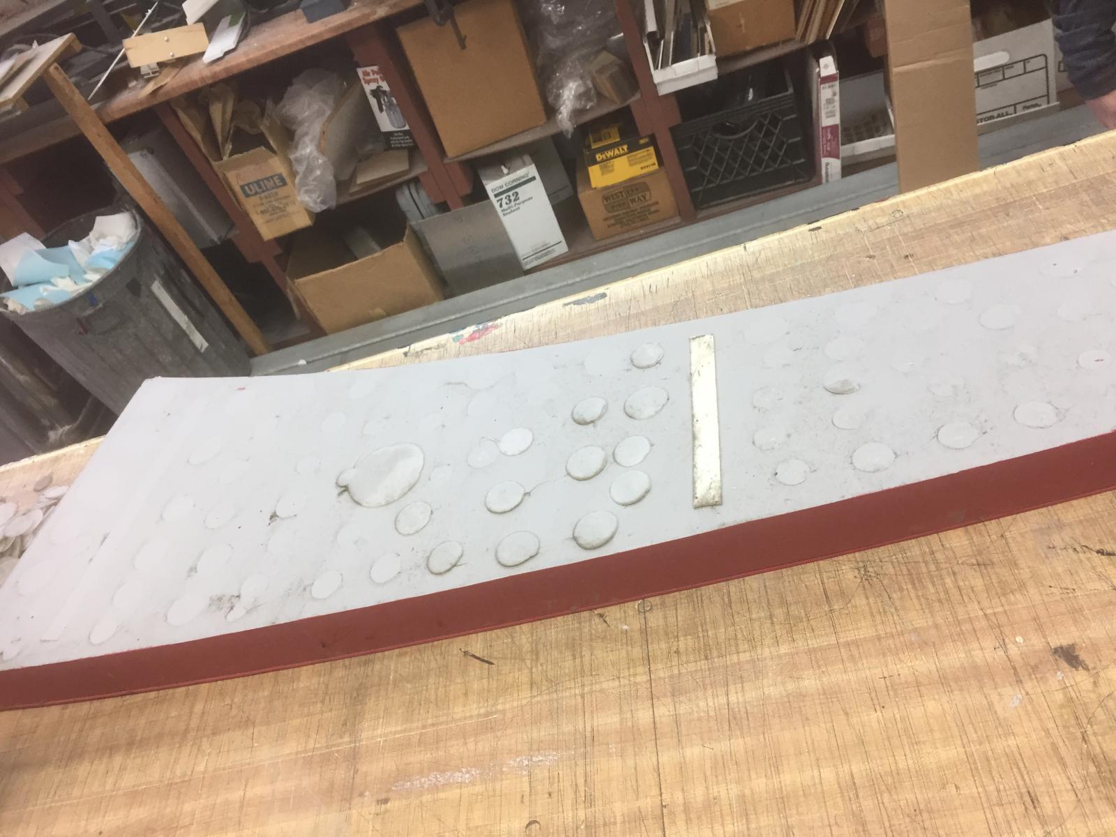

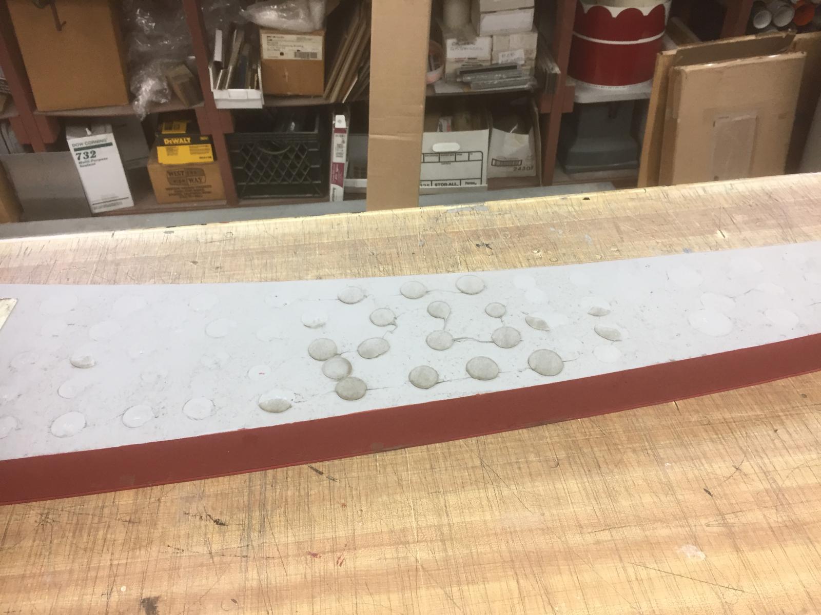

I noticed you're using dots of silicone. I was trained to use long seams of it, around the perimeter with a gap at the bottom for drainage. Silicone works by surface tension and perimeter beads get better adhesion and have less edge exposed to elements.

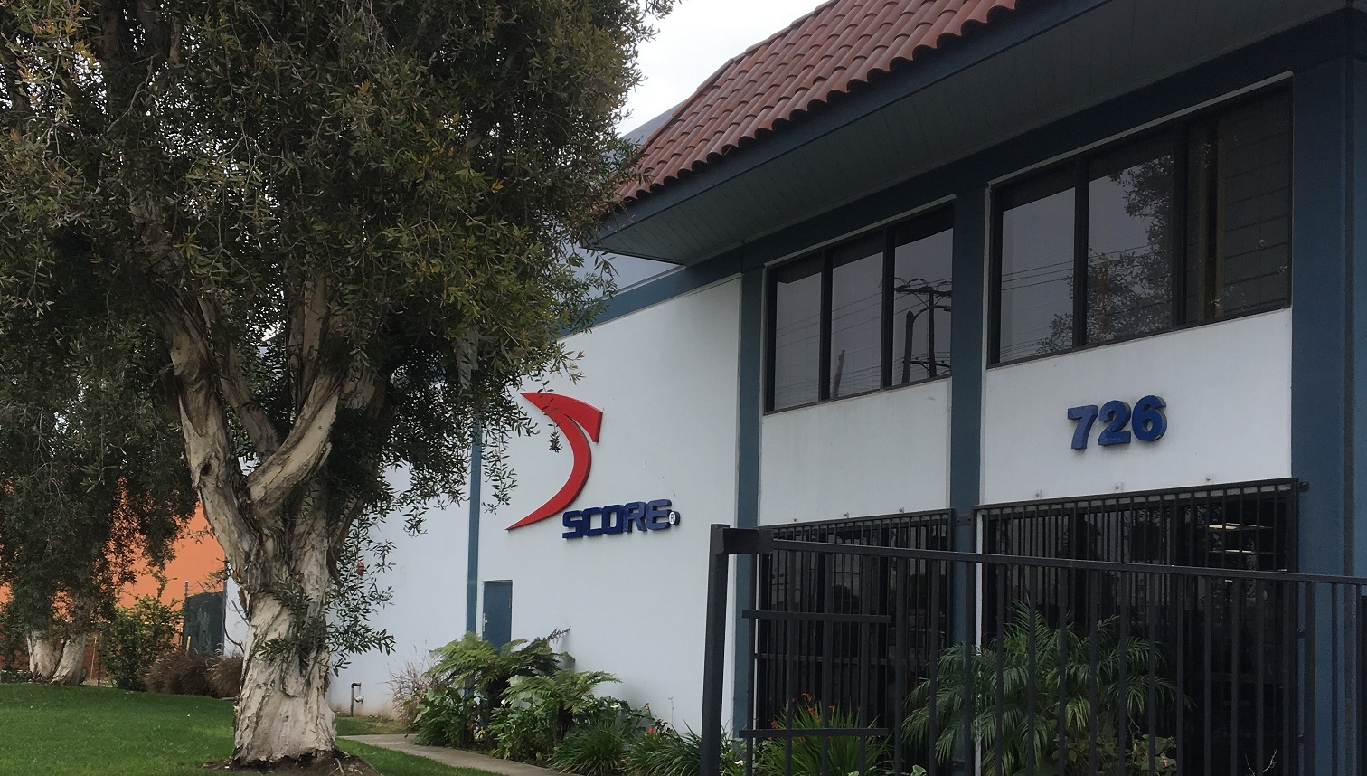

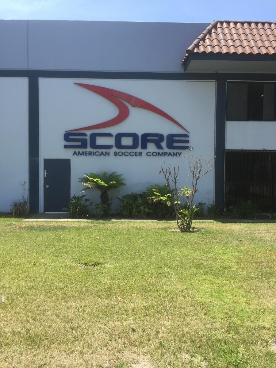

Hello Fellow signmakers,
Although I have been making and installing signs for 31 years, I am still learning and need
your suggestions for a better installation for these foam letters with plexiglas face.
I previously had made this type of letters before and they lasted 10 years plus.

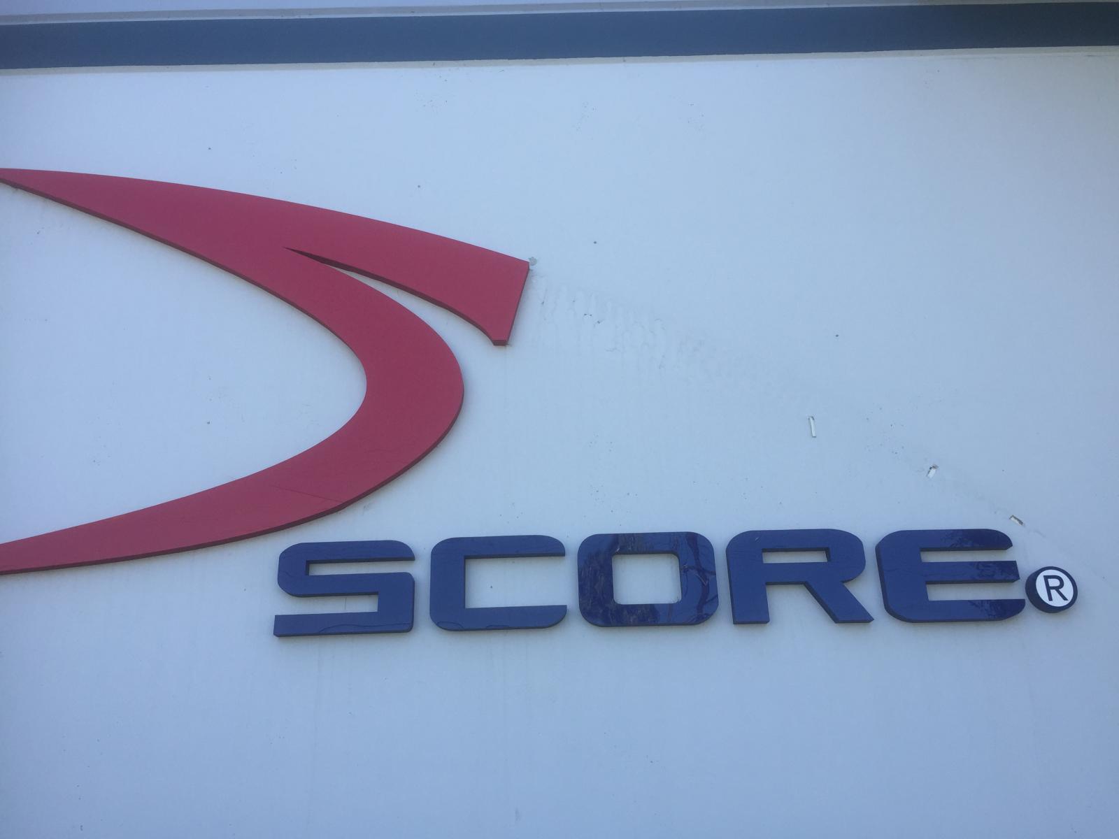

This logo is falling off after 8 months.
Letters are 2 inch thick dense foam (not bead)
Foam was painted with Glidden brand primer (Gripper) front and back.
1/8 inch acrylic glued to foam with Dow Corning 732 clear silicone adhesive.
Wall was painted with exterior Behr paint from Home Depot. Paint is sticking well to wall.
Logo and letters glued to wall with Dow Corning 732 clear silicone adhesive and some 3M VHB Tape.
The section that fell off did not break.
The wall had no silicone residue and had a couple of sections of VHB Tape still hanging on.
The silicone removed pretty easily from the back of the foam logo.
So it appears my adhesive is not working well in this situation, although i have been
successful with the mounting method previously.
