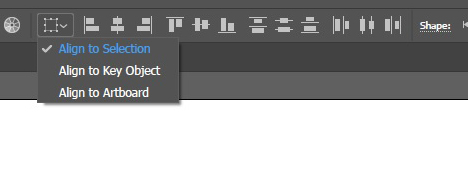

    I'm having a weird issue with Illustrator that I'm out of ideas on how to fix. When I use the alignment (as pictured) to align certain objects to each other or the art board, nothing happens. I've searched through all the preferences and settings, couldn't find anything that would reference that.
    Any suggestions or advice??

    Make sure you have your image etc selected and you are selecting Align to Artboard or Align to Selection,There be a section to select one or the other. If you cant get it to work send me a pm unless someone provides something else.I will take a screen shot and repost in a sec.
    Also make sure what your selecting isnt grouped together..

    Yeah I'm selecting it, but nothing aligns.

    This could be a bunch of things. Objects that are already grouped are considered 1 object so it can't align to itself. If there are clipping masks or compound paths it could affect the alignment. Also, text tends not to align properly unless they are converted to lines.

    It was set for that. I just selected "Artboard" and then back to "Selection" and now it works. LOL!

    Umm, have you tried the Distribute Spacing buttons in the third row of the Align panel? They do exactly this.
    The trick is, you have to select your objects, then left click on one to make it a Key Object, or simply switch the Align To option to Key Object. Then you can type 0 (zero) as your spacing value in the box at the bottom of the Align panel, and click one of the Distribute Spacing buttons to line up your objects edge-to-edge vertically or horizontally.
