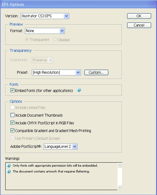

We used to have frequent issues with gradients where I am employed. Assuming you have not already tried this, when saving the .eps file, make sure to check the "Compatible Gradient and Gradient Mesh Printing" option box. Most of our gradient related issues disappeared when we started using this feature.
