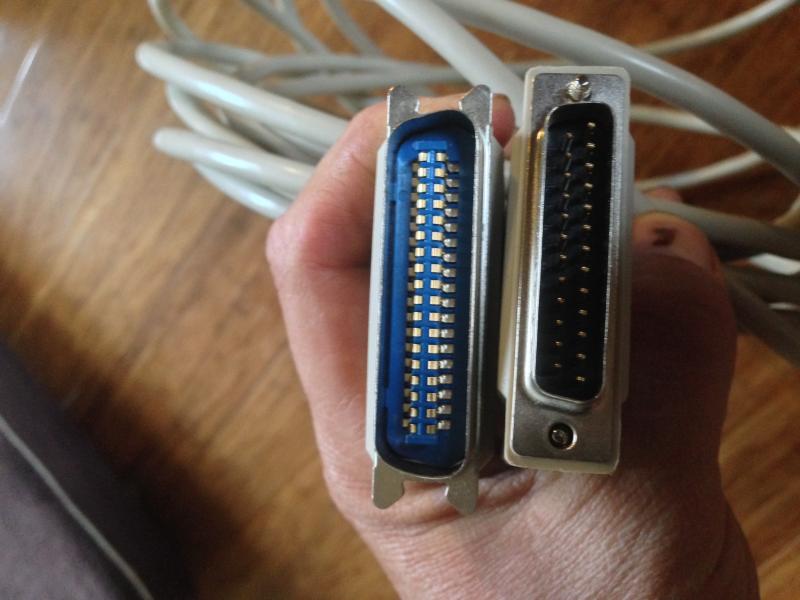

I am not stuck on Mac. I will explore all options. I was just given a PC laptop which runs Windows XP. Is that too old? Also, there is no place to plug in the

Hi Bill,
I am not running anything at the moment. I bought the Roland plotter and am trying to figure out how to run it. I have a usb-to-25 pin cable, but I'm not sure my computer recognizes it. I don't have software. I just got an old PC laptop and I am trying to figure that out too. I obviously clueless, but appreciate any and all help.

laptop pc
I got the laptop pc plugged into the plotter and downloaded a driver. Now, what software? I have an old computer running Windows XP. Cant run the trial of corel draw on it.
