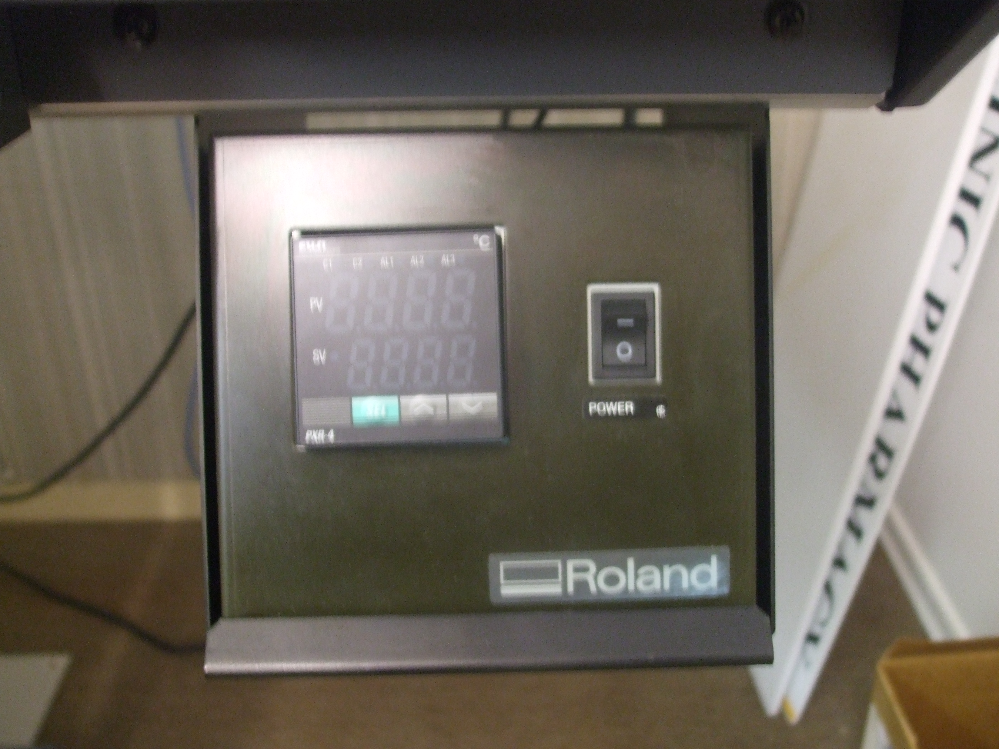

    Sounds like the control box has been changed for a cheap generic type
    Show me a picture of it
    In the mean time check the bed temp with a temp gauge to find the real temp

    Here is a picture of the heater box as requested.
    Thanks
