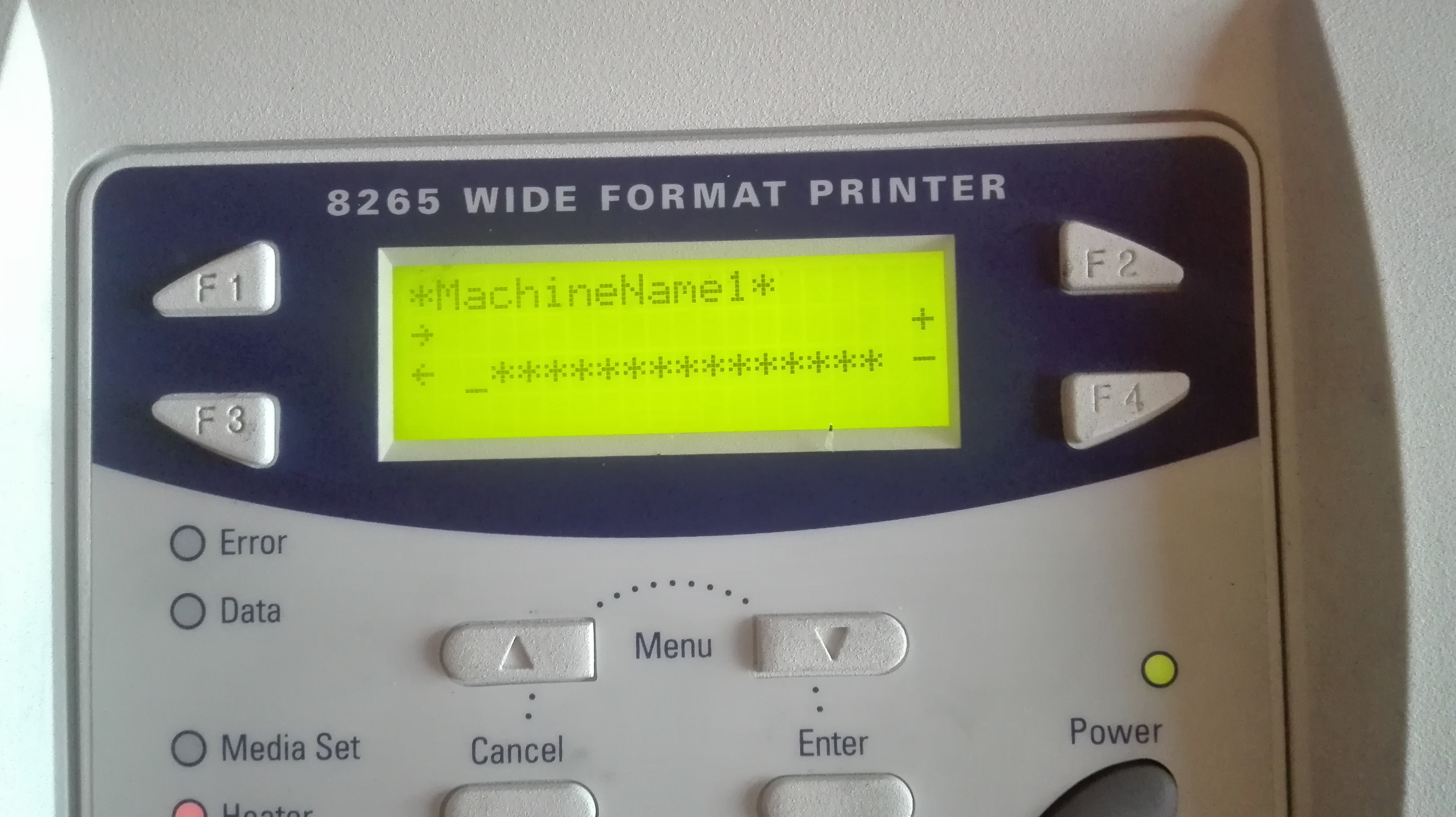

could this be the cause why it is not reading any cards i insert on it?
that shows up after i put special code on the printer.
is the mainboard locked?,what can i do?

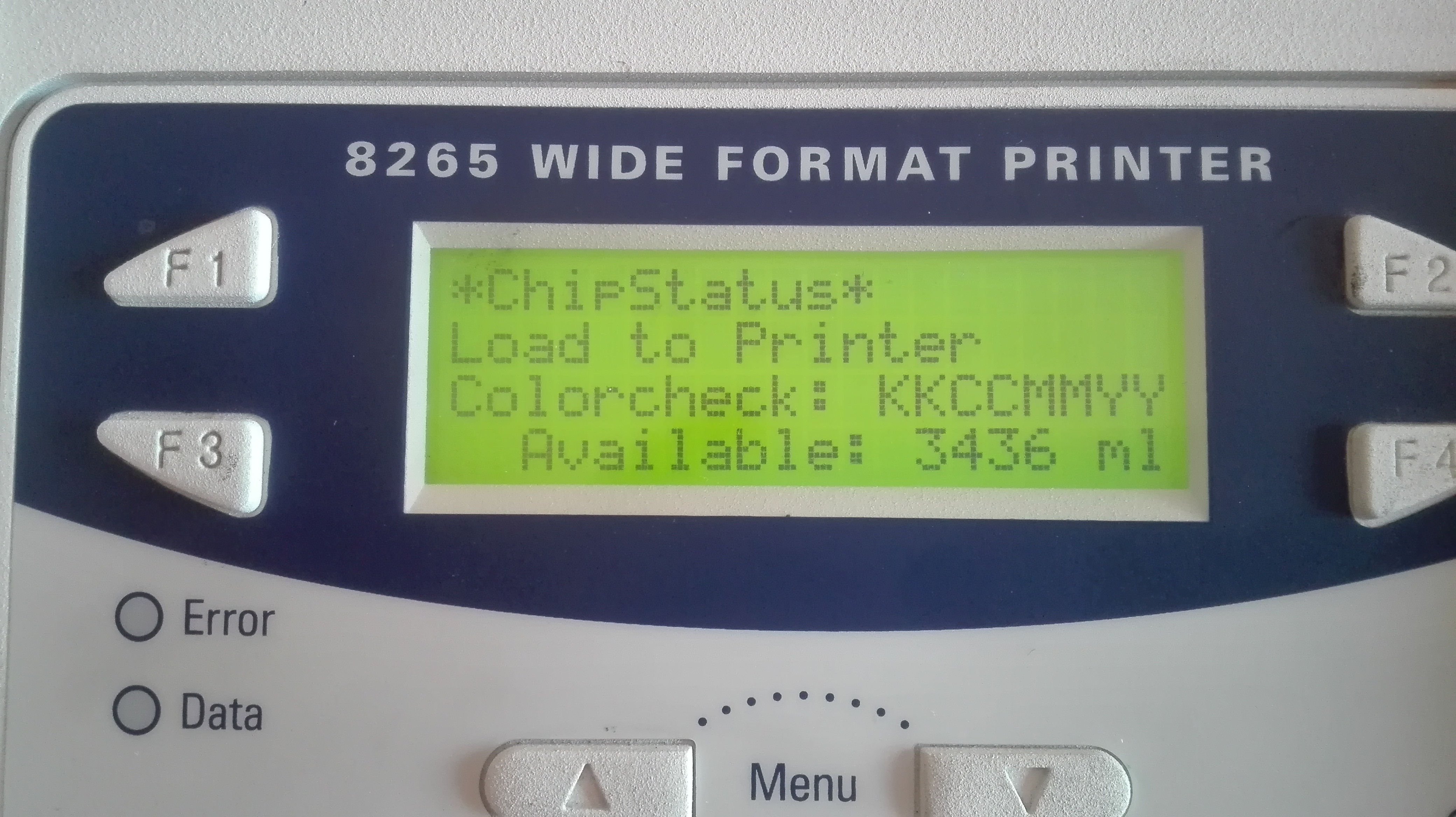

i have managed to load credits on to the printer,had to change from eco to mild solvent.

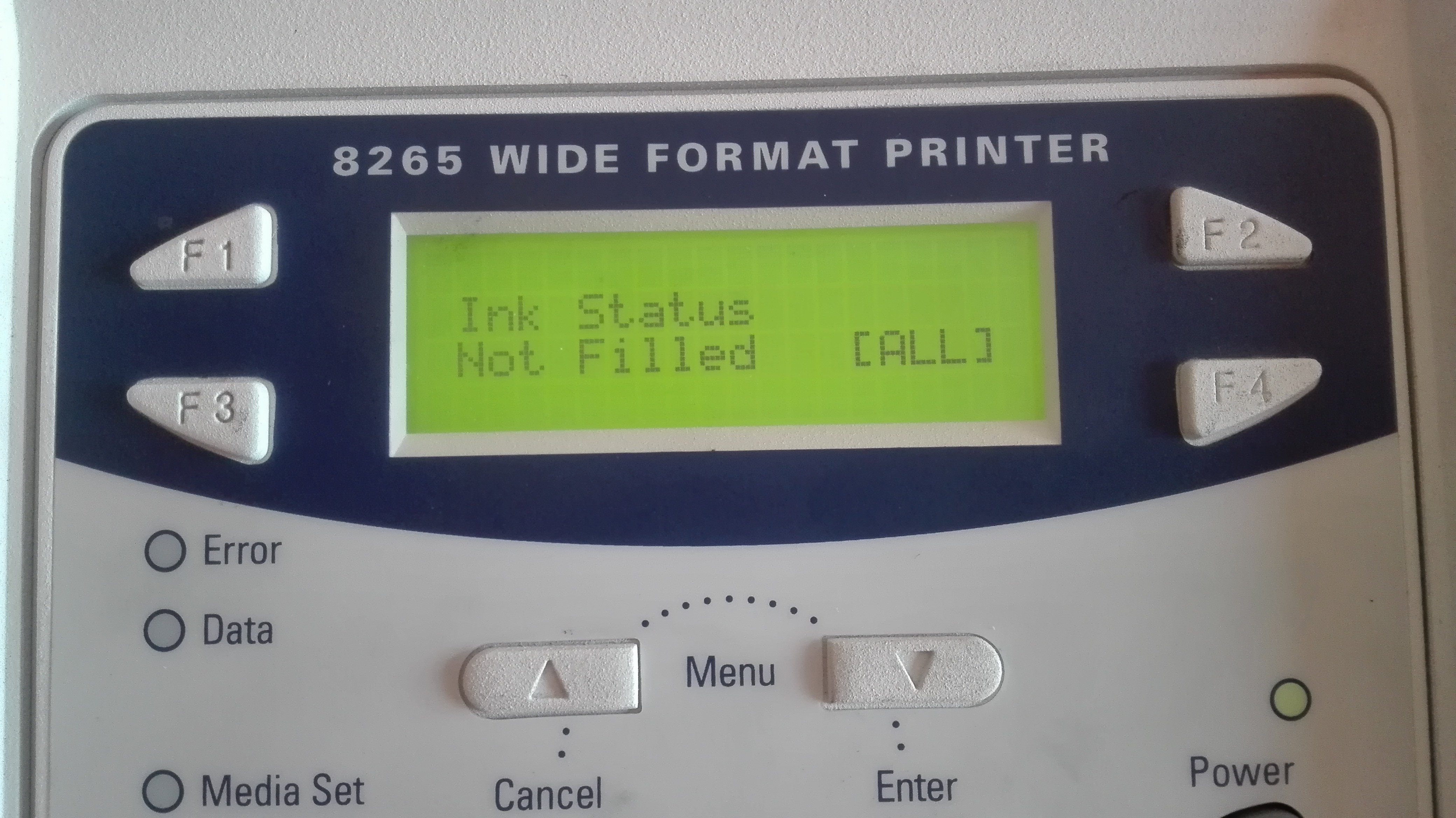

now i have another challenge,even with ink credits loaded it still shows "ink status not filled (all)"
any ideas?
wunder
start ink load procedure.......and disconnect the inkpump motor connector (grey plugs) and wait that system ready with the inkload procedure ! or what you like to do now ?
Mr Moss
thanks for the info but which one is the ink pump and when do i disconnect the grey plugs?
