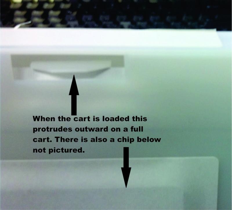

What actually tells the printer it is low on ink? a sensor on the cartridge, or the printer, or is it the chip attached to the cartridge. If the chip does the printer calculate the amount used when a file is printed?
Don't know what the problem could be, but that's got to be a bummer.... throwing all that ink away all this time.
I'm not acquainted with the Mutoh's , but how does the machine alert you to the fact, your ink is low.... or out ??
In the Roland's there is a tab that shoots out and it sets off a beeper. Can you by-pass the tab, it you have something similar and just keep a close eye on it ?? That might be what Fat was saying, but it is how we monitor ours much of the time. Never run dry, yet..... in almost 6 years.

The pictures show what tells how much ink is in the carts.
