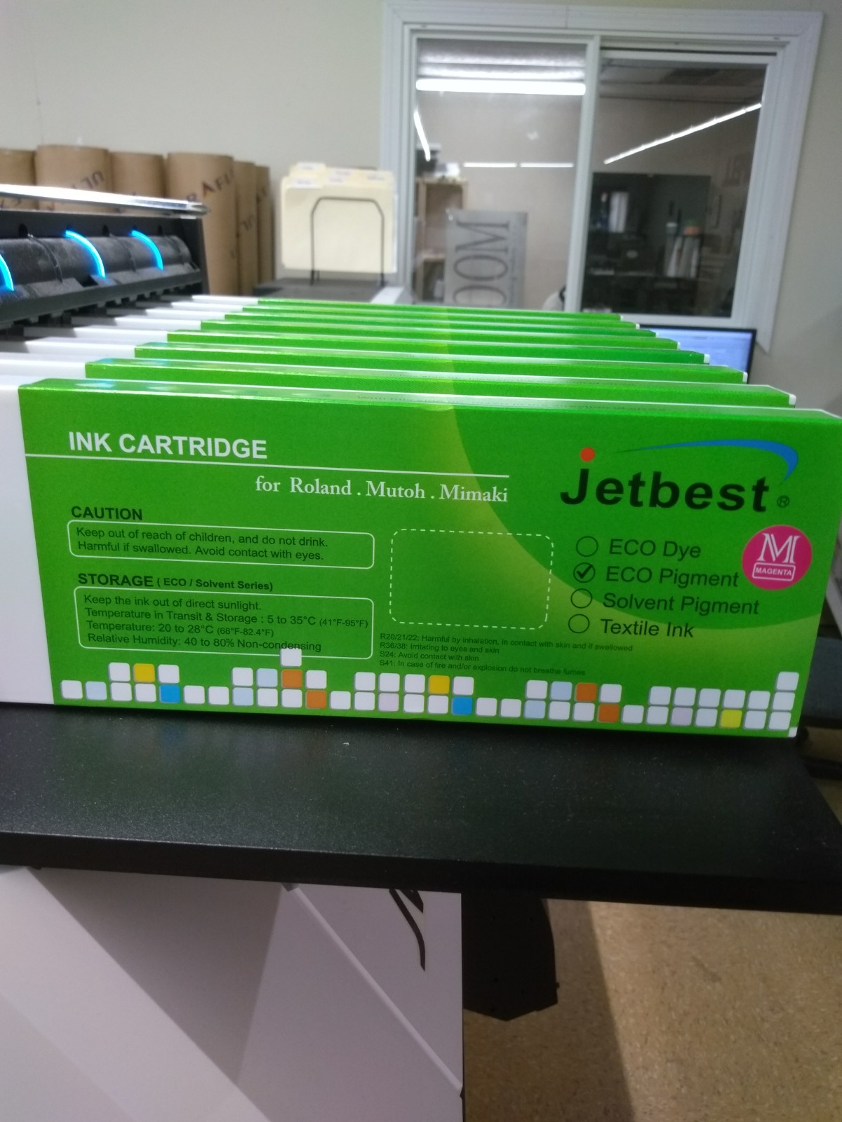

premiercolour
Merchant Member
I recently tried STS inks. I have a Mimaki CJV-150. The first cartridge to be switched to STS was orange. Instantly started having problems with clogged nozzles. Ran more cleans then I ever have in the prior 2 years with my machine. Would get all nozzles back and within 5’ of printing would clog again. Switched back to OEM orange and the problem completely cleared up. Emailed STS customer service and they can’t even be bothered to respond.
Give us a try and give review on your honest opinion. We are not just another online seller. We are technical, know what we sell, has been around for ten years. Most importly we pride ourself to be honest, good people.
Are you using Mimaku ss21 or es3? Because theae two inks have different color gamut. Jetbest ink will give you factory color. PM for more information.
https://www.premiercolour.com/colle...eco-solvent-ink-cartridge-for-mimaki-printers
