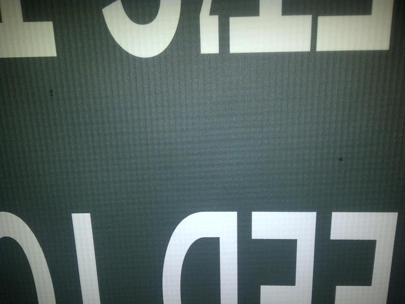

i've noticed lately, especialy on banners........that i'm getting very small what looks like dense ink spots in random places on prints. i just did a dark green banner and i noticed it again........looks like very small ink spot/drop out on the green part.
the heads are clean as i did a manual clean of everything a couple days ago. any suggestions on what it maybe or how to avoid it?

a single fiber will cause the random spots.
especially with banners, you really can't guarantee that your head will be fiber free 100% of the time. manual cleaning will definitely help, along with scheduled auto cleans. but at the end of the day, you can only do so much.

If it's a drop of ink (usually one color, which may appear to be a dark spot as it mixes with the color underneath), it's usually due to an accumulation of ink on the head. Sometimes lint or dirt on the head will cause this. You probably need to do a good manual cleaning again.
Printing on banners causes a lot of fibers to catch on the head sometimes as the head passes over the ends of the material. You can help avoid this by hitting the ends of the banner roll with a torch to burn off any "hairs" that may be there.

btw, just for explanation's sake. the fiber catches the ink, collects it, and then plops it in when it's heavy enough.

Do manual clean...then,
Select head in up position and use long smoothers to hold down fiber ends of banner material.
I had this and since doing the above Ive had no issues.

i have always done this, and i had just done a good manual cleaning. it is heavy dark ink spots, quite small but there are still there and in random places on the banner.
maybe try cleaning again then? could it be something to do with the cap tops? i know you should change the cap tops approx once a year, my tech suggested once every six months. i've had the printer since last june/july...

heres the pic

when I get this happening I shut down the printer and swing the heads over and use an led light to look closely and usually see the culprit which is not to visible without a light source

Seeing that the drops are of the same ink color as you are printing then it has to be a case of ink build up and then a drop falling off. Most times its a fuzz or a hair like mentioned. You also can have a buildup of ink around the outer edge of the print head that catches the ink spray and builds up.
If it was a bad damper that was not sealing, the drop would be more a solid color from that head and not the color you are always printing.
Do a test print of a soild color and then stop the print and look at the bottom of the head to see if you can see a drop forming and where it is.
You may need a mirror to see under the head better and of course a flash light.

i did a manual cleaning again and got my flash light out and had a good look. didn't really see anything but carefully wiped down the sides etc just incase. i'll see what happens.
makes sense if there were fluff or something underneath making the ink drop sown randamly.......just didn't see anything.

Try to do manual cleaning also for the cap-tops, wipers and scraper. It's useless to do manual cleaning for the print head if the others parts are dirty and have all kind of...things on them. The print head is going to capping position and take dirt and other stuff from there.
