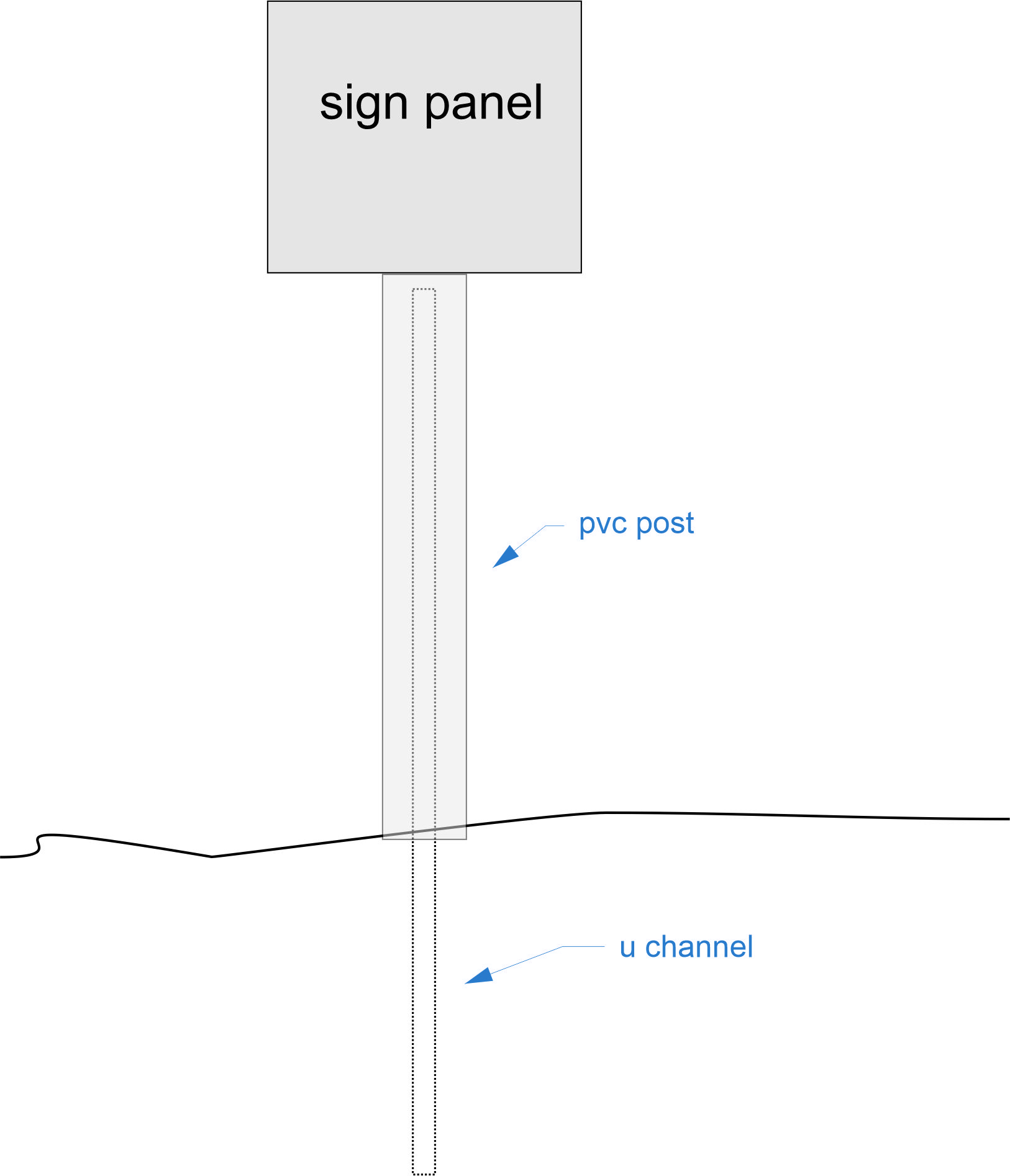

I'm old and lazy. We do real estate and any temporary signs this way.
Attach the sign to a sq pvc post or posts.Pound a u channel in the ground and slip the sign and post over the u channel.Drill a hole into the pvc column and shoot some expanding foam into it.
