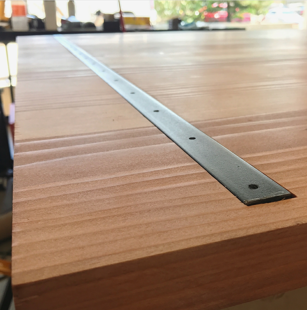

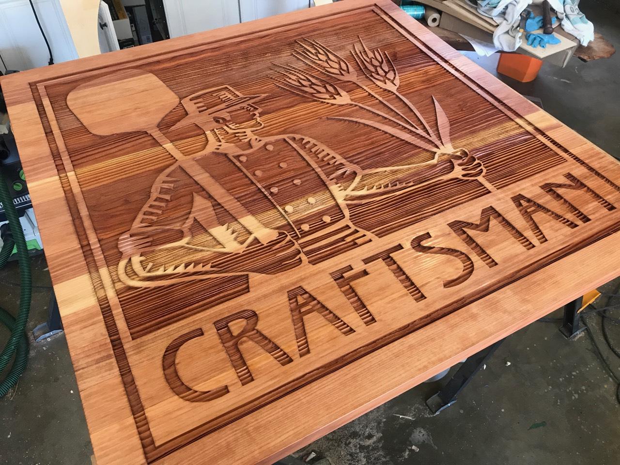

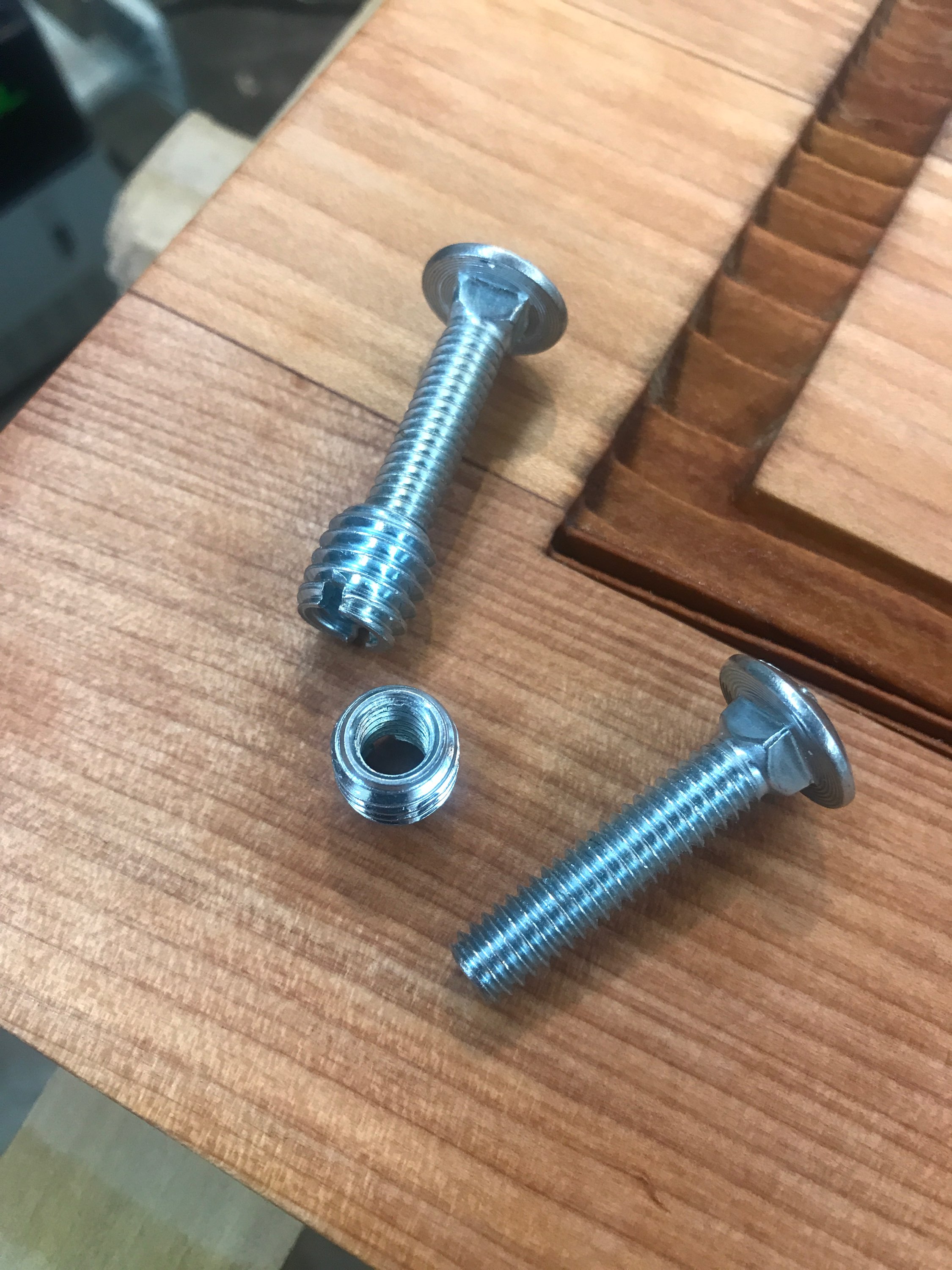

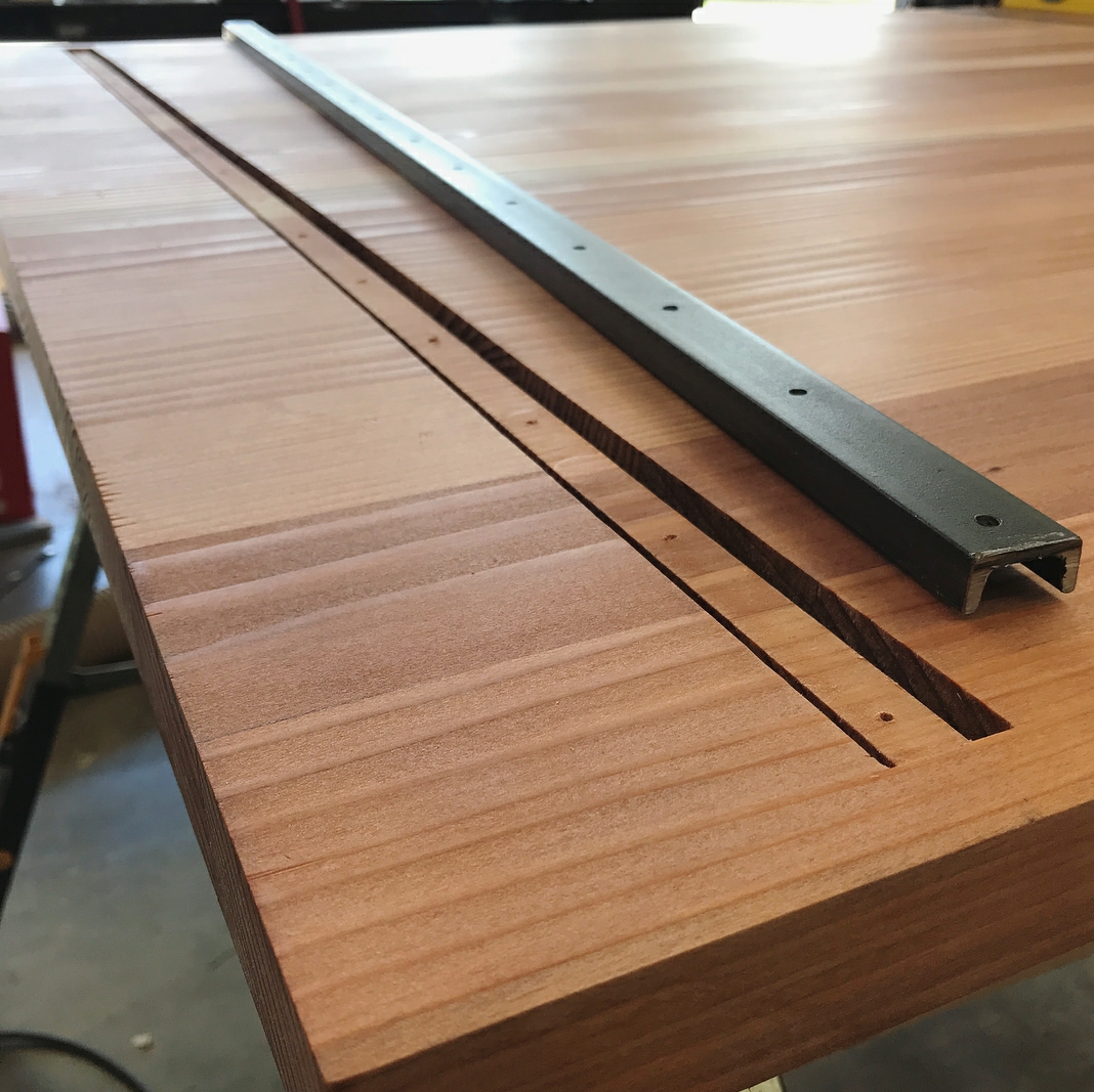

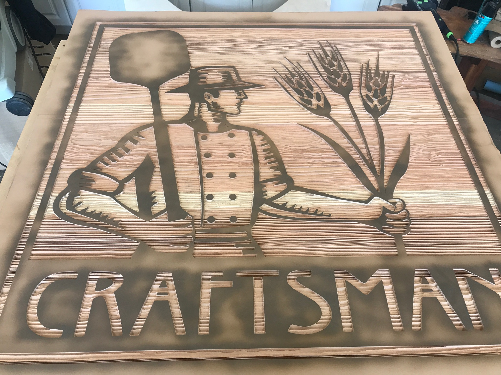

    We made the blank ourselves using redwood and we did biscuit joint the pieces together. As you'll see in the pictures we also added support rails down the back to try and help avoid the warping problem. For mounting we spoke with the customer our concerns and they agreed to hang it themselves. They did knock off the one stone that stuck out the most. We mounted a french cleat to the back of the sign. We supplied them with a 36" x 36" piece of MDO to mount to the wall, they used either toggles or were going to try to hit the studs using the plans from the previous owner. I did not ask how they finally did that portion of it. After the wood was mounted, they then could mount the wall side of the french cleat level and not have to worry about the stones anymore. We also added threaded inserts and bolts at the bottom to support the sign away from the wall. Also I did not like how the original sign was super glossy and somewhat gooped on, so we finished it in a thinner better finish.
