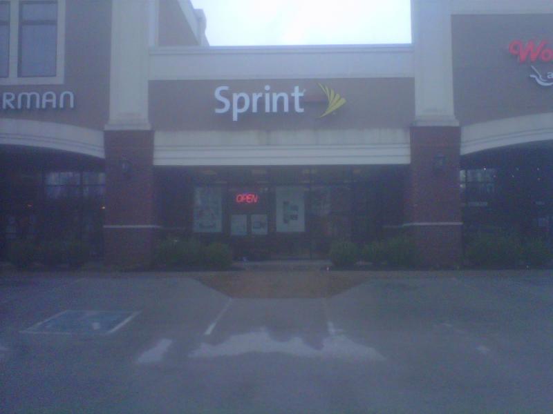

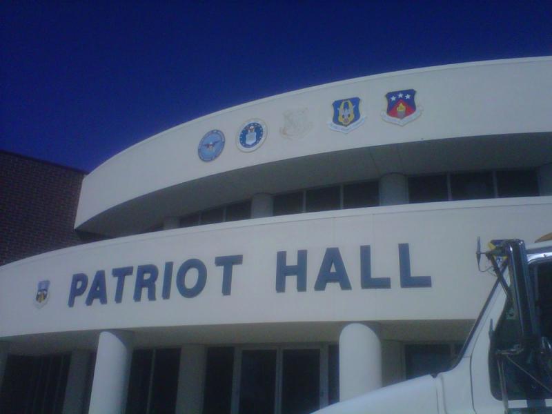

Check for an access hatch or get access behind the fascia and see what's behind it. A little more time intensive maybe but you'll have a definite answer as to what you're attaching to.
If you are bringing a second person and there's access behind the fascia, toggle bolts are a nice option because your penetrations will be minimal (rather than drilling larger holes for embedded anchors, you only need a 3/16" hole for the bolts).
Just another idea - definiteky not saying the other recommendations are wrong.
