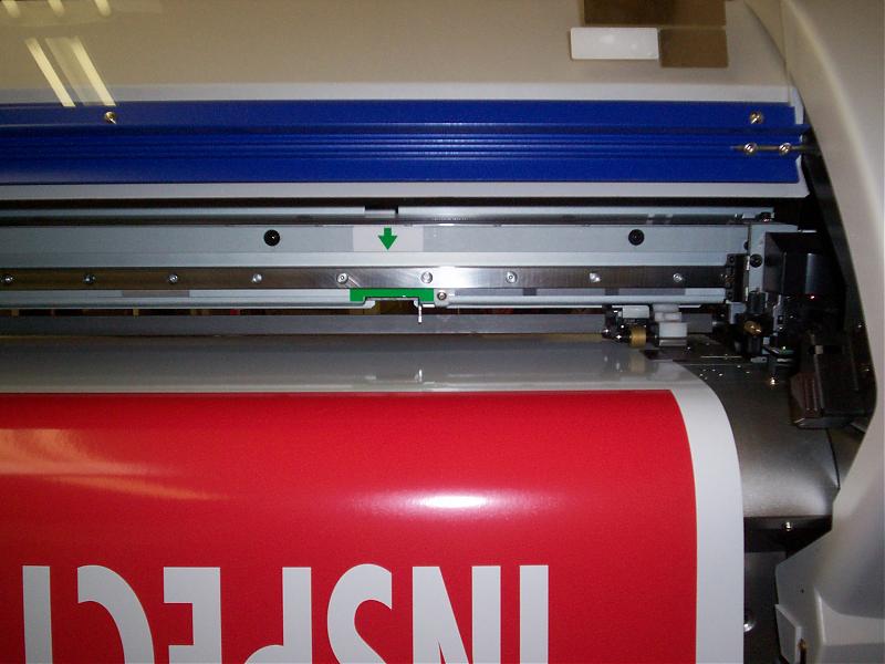

    Ok, Ken, walked over to my machine raised the cover and snapped a pic. You can clearly see my right pinch roller. Is yours directly below the "grey" tab looking thing as mine is? The grey tab looking thing looks like duct tape in the photo, but the edge of your pinch roller cannot be outside of the grey indicator, even so much as 1/10 of an inch. It must be directly below it.
    Try that. If that's not it, let me think about it for a while.

    I've been using this machine for over 2 years now. I know how to correct a pinch roller misalignment.
    I had just done a firmware update to v6.2 and now this problem.
    Do you think it matters if full scan is enabled or disabled, or any other setting?
    I went into colorip2.2 and instructed it to set for maximum width. I have 30 inch material in the machine with the pinch rollers set out at the edges, under the silver marks.
