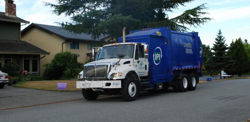

This is a similar truck. I am not sure if the back is as long, but you can see the belly and the seams.

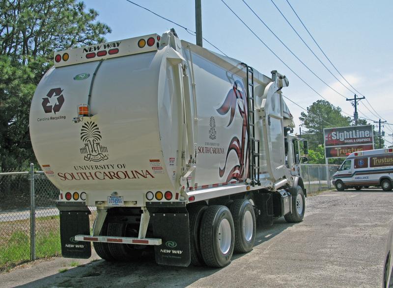

We do them the same way Colorado mentions. Because of the curve we tape the panel in place and tape hinge across, applying the top half then the bottom half. On the one side if the ladder is in your way that is also easy to remove, 2 bolts at the bottom and it just slips off at the top. This is a print/cut one we did a couple of weeks ago - in some respects even trickier with the large open areas on the sides. We also use 3751 (quite a bit) but also use 3M 180CV3 a good bit as well. If you are installing outside in the heat then you might want to app tape the material with a medium tack tape made for digital prints. Does not matter what brand, outdoors in high heat you are going to have to be careful about edges curling in and the material stretching. App taping it can help with that.
