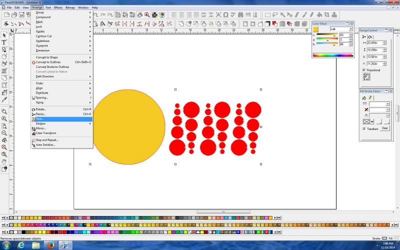

Try This in Flexi Pro:
Is this feature not available in Flexi Designer 10.5.1?
I don't see it in my menu. Or am I blind.....
ChrisN
Even though SAi says this about FlexiDESIGNER,
Get all the design, layout and image editing features of FlexiSIGN-PRO,
it is not true. FlexiDESIGNER does not have some features FlexiSIGN-PRO has. A few I've noticed (on FlexiDESIGNER Cloud 11 sp6) include true-shape nesting and i-cut marks.
thewvsignguy
Thanks for that info, it's not a deal breaker but good to know. I like setting up most of the production files when I can (designer), that seems like a neat trick. I'll just use it on the RIP computer.
