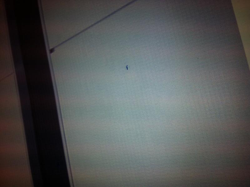

    Title says it all? If not, what is this called and how do i stop it?

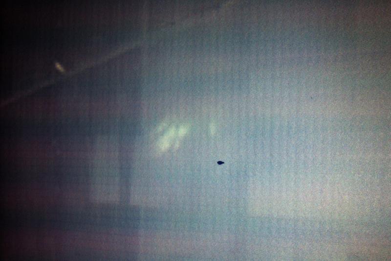

    here is another photo

    you probably have dust or hair stuck on or around your print head. once enough ink has built up on a piece while its printing.... DRIP, right on your print.

    I think 401 is correct.
    You have a case of DRIPPAGE.
    Clean the head & the capping station/wiper - if it continues go to the doctor and ask for a shot of penicillin.......

    I just had this at one end of a 10' banner :0( Upon further investigation, it was fuzz on the mag/yellow head. Two big drips right on the print errrrr lol

    401, GAC, Dizzy: Thanks for the genuine responses! I'll look tomorrow :)
