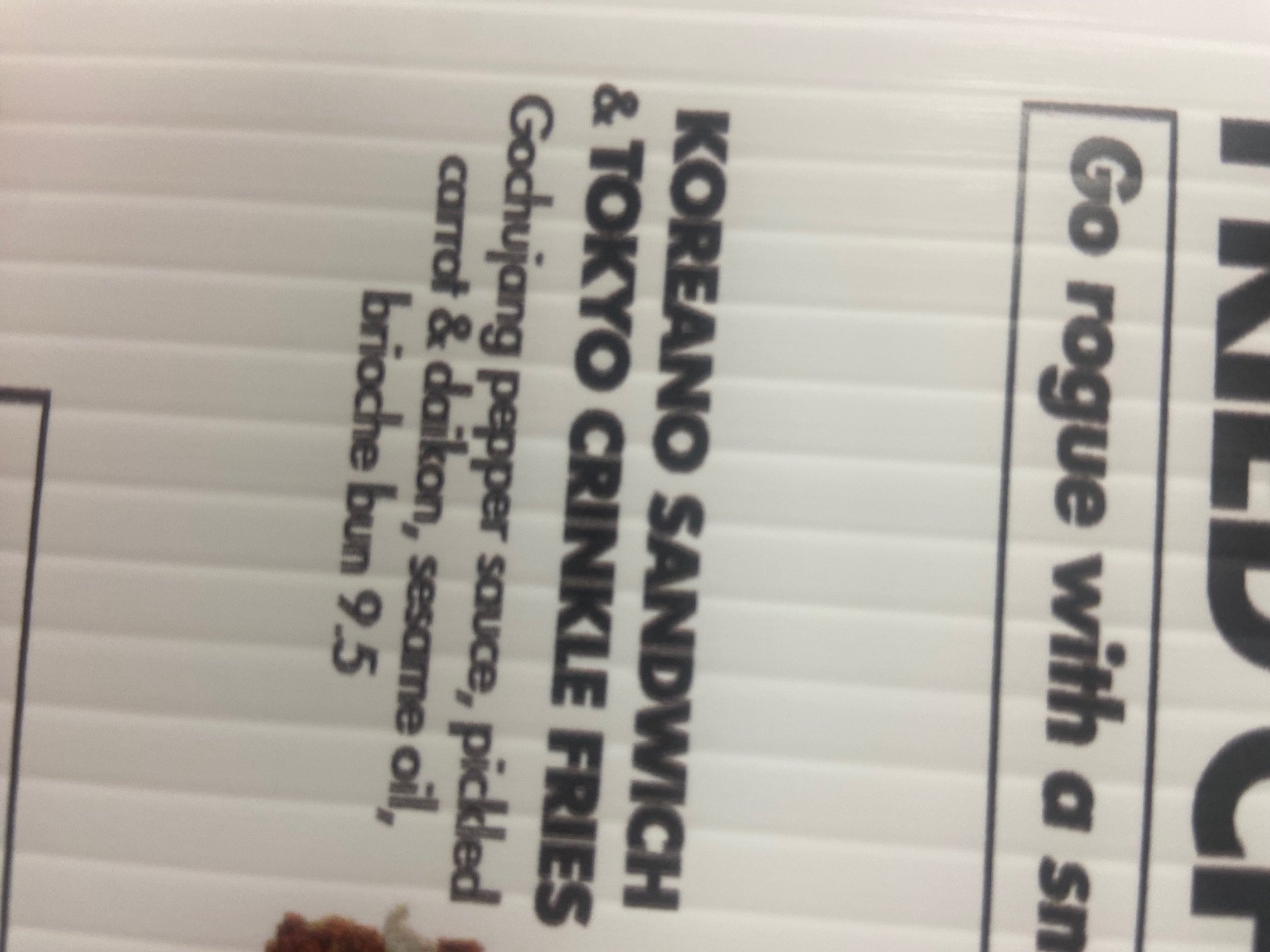

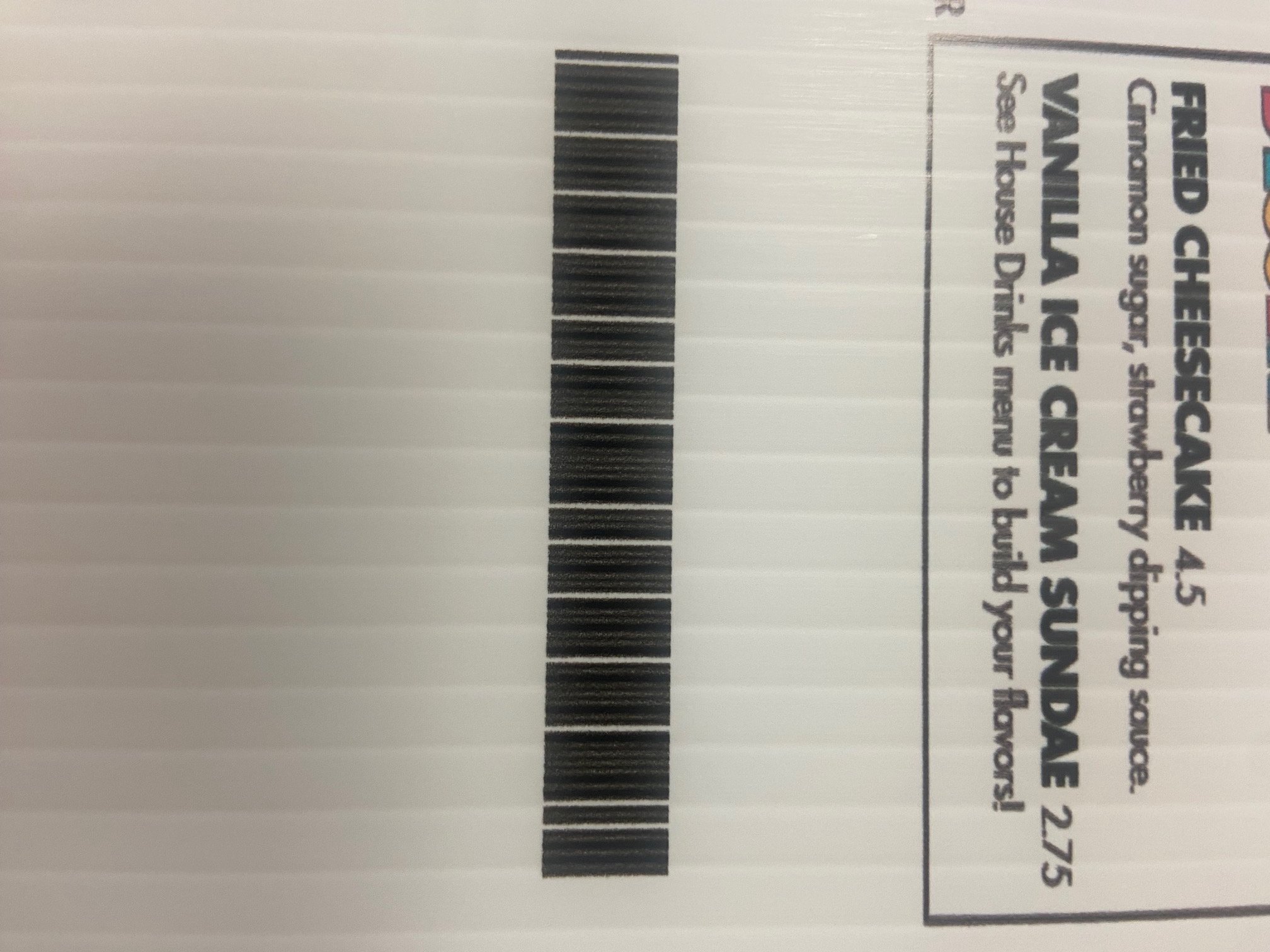

We started having an issue with our R-1000 where it has started printing blurry. Typically when we see this we would think of an alignment issue or a head height. Since head height is controllable on it, we have checked and reseated the print heads and recalibrated but are still having the same issue. It is in all colors. Anyone seen this before or know what is happening?
I'd check your optimizer settings, which control how the ink adheres to the substrate. Maybe you're using too much or too little for this substrate. There are test plots that will show how each ink is performing, including optimizer.

It's alignment, height or feed depending which way these were printed. Maybe it's measuring the thickness wrong or something else gone bad.
I would do a automatic alignment on SAV at 0 height and then test again with manual height.

I thought I'd post the solution. The height measuring tool lost it's origin. HP had to log in and recalibrate. Unfortunately, it is not user adjustable but it was a quick fix. Down side is the phone call for support is $250.

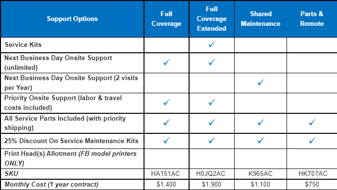

Now my warranty is up, and in case anyone is wondering here's what HP's extended warranty costs are:
Unfortunately, in my opinion, the contract is not worth the bill. HP designed a machine that when properly cared for does not require many on-site visits from technicians. I believe I've seen most, if not all, catastrophic part failures and fixed them myself at this point. Once you know the procedure for fixing these things they are simple and require minimal tools. The most memorable machine failures so far are:

Perhaps if the warranty included a print head allotment I would reconsider. I will ultimately see if my decision to go without warranty is wise. The priority parts shipments are the only real benefit I see in that chart. And I'm sure HP prices their parts at a fair rate without warranty... :rolleyes:
