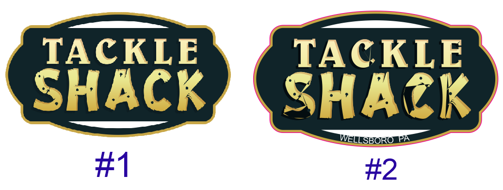

I opened the original file in RasterLink Plus, to my surprise everything is intact. Thank you for letting me know..... I added the cutline around the graphic and added the town & state to the graphic, as requested by the customer. It did not save correctly. #1 picture is correct #2 picture is not correct.

Update on issue.....For kicks & giggles one day, I turned on my old "gateway" desktop computer which has Corel Draw 2019 on it. The file opened perfectly. My jaw dropped! This explained why some people opened the file and some could not. This left me with 2 questions....is the problem the OMEN laptop that is only 2 years old? or it the problem Corel Draw 2020 (the file did not open correctly in Corel Draw 2019 on the laptop either). I called HP first, as I have an easier time dealing with HP support over Corel Draw Support. The OMEN laptop had "windows 10 mirrored imaged" I don't know the difference between mirrored image and reformat and it does not matter, had everything on an external hard drive anyways, as I learned a very hard lesson years ago. Took a few days to get all programs up and running again, as soon as I got Corel Draw 2020 going, I opened the same file. It opened perfectly.
I don't really know what the problem was with the file, but I really don't like this laptop computer, as the issues with this has been great! I truly thank each and everyone who responded and offered help. I read each and every response, very helpful.
