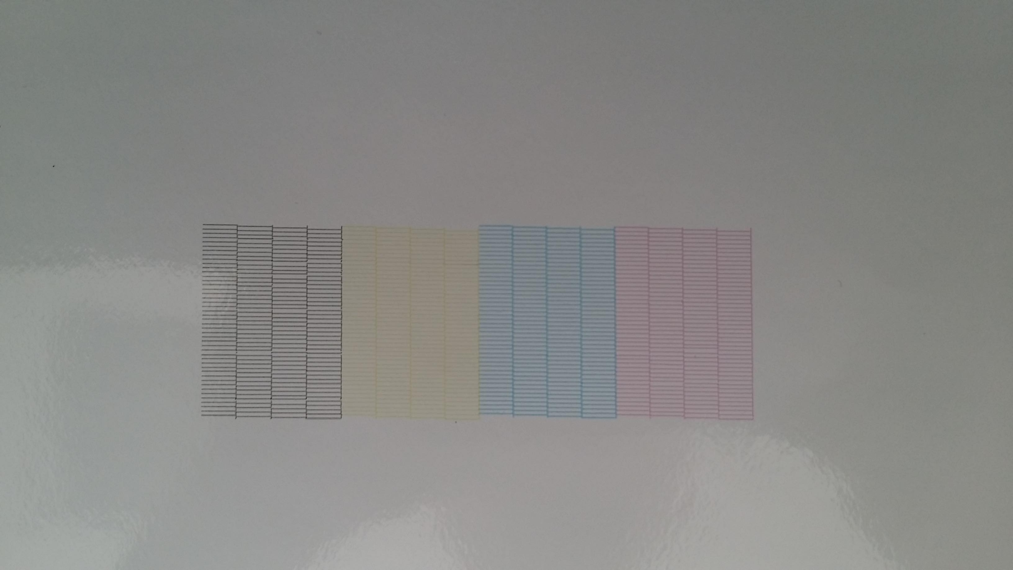

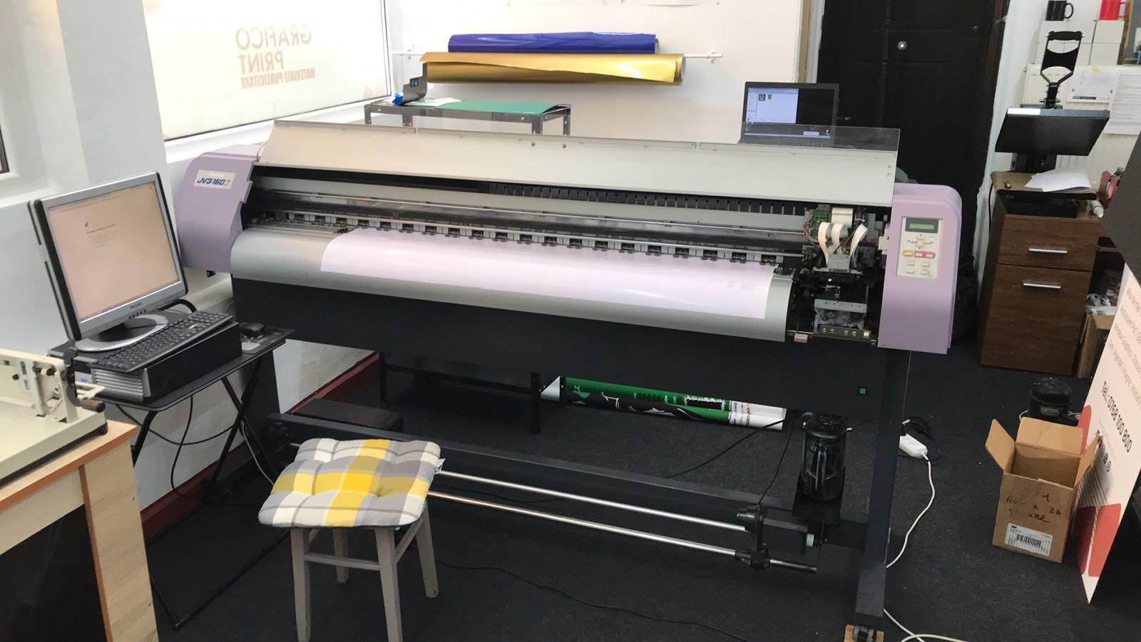

Ok, so I've got a better deal for a JV3-160S (1000 €) with new printheads, one new spare print head, the printer is in perfect condition. The nozzle test are very good.
I'm new working with MIMAKI, and I have a fiew questions.
1. on the printhead cover thers a hole and it says Media Type: Thick/Thicker, but i cannot find how to move the printhead up and down?
2. When I put the media in, the vacuum is not that powerfull to pull the media down. Is there a way to clean the vacuum?
3. I use PhotoPRINT Server Pro, can someone plase share the settings for: Canvas, One Way Vision and Banner?

What color ink cartridges are in the printer? The 160S is a 3 head printer using CMYKLcLm, meaning it uses light cyan & light magenta inks. I do not see the light inks in your nozzle test.
