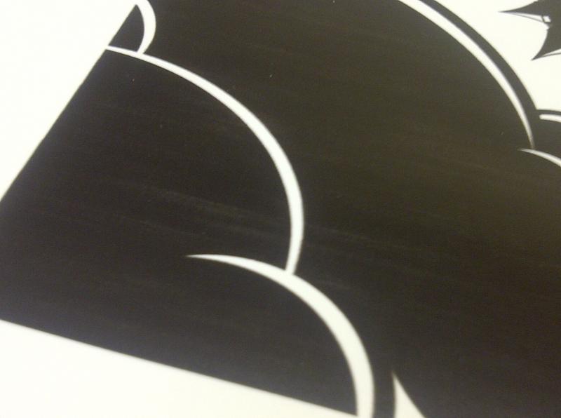

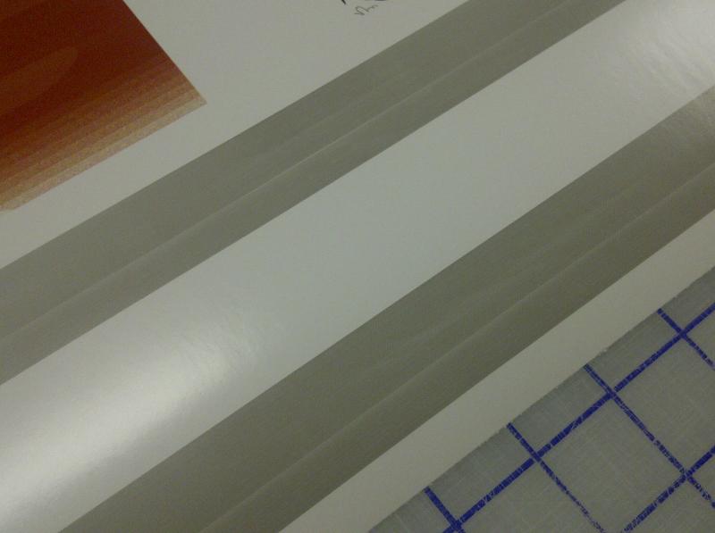

OK, I'm completely lost on what to do here, and now its affecting my clientbase. I'm getting what looks almost like a starvation but its not at all uniform. It happens in every color, vector or image, randomly throughout all prints. I'm attaching an image of a rich black print and a media comp line to show.

Black Photo looks like it's just your media comp. not set right.
the 2 passes should look like a solid line. gotta get ride of that white line between them

in terms of the media comp, that isn't a while line, its larger spacing between the rows of dots. I dont know why it does this. My media comp on the one closer to edge of paper is right, in terms of lining up the rows of dots between passes with uniform spacing.
As for the black print, it cant be comp. If it was, those "streaks" would be from one edge of the y axis to the other. Its not. Its erratic locations in various spots in the passes.

my money is on ink starvation. bad dampers specifically. looks like your wet printheads are starting the print fine, but suddenly hits a hump where the ink doesn't feed quite rite.
