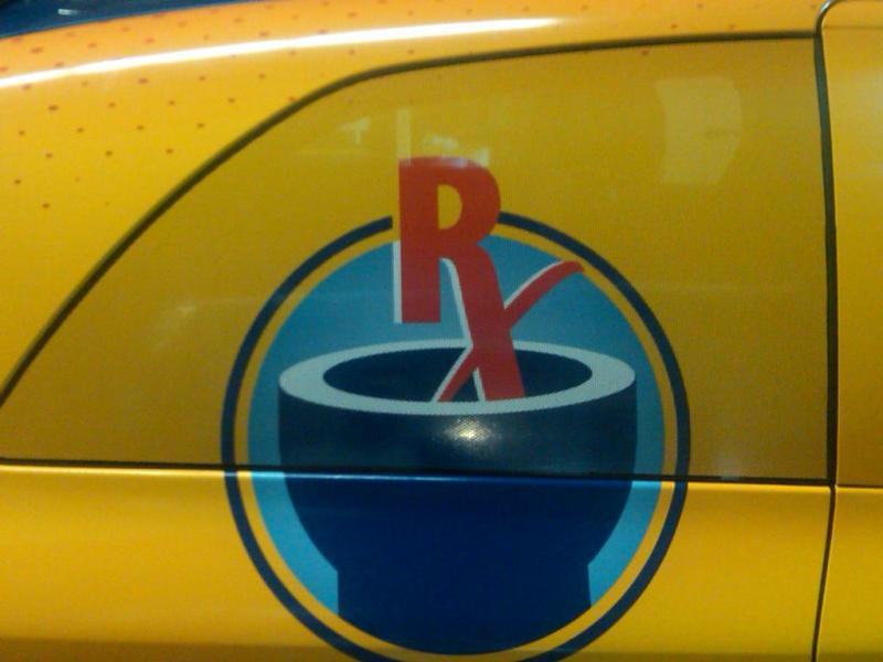

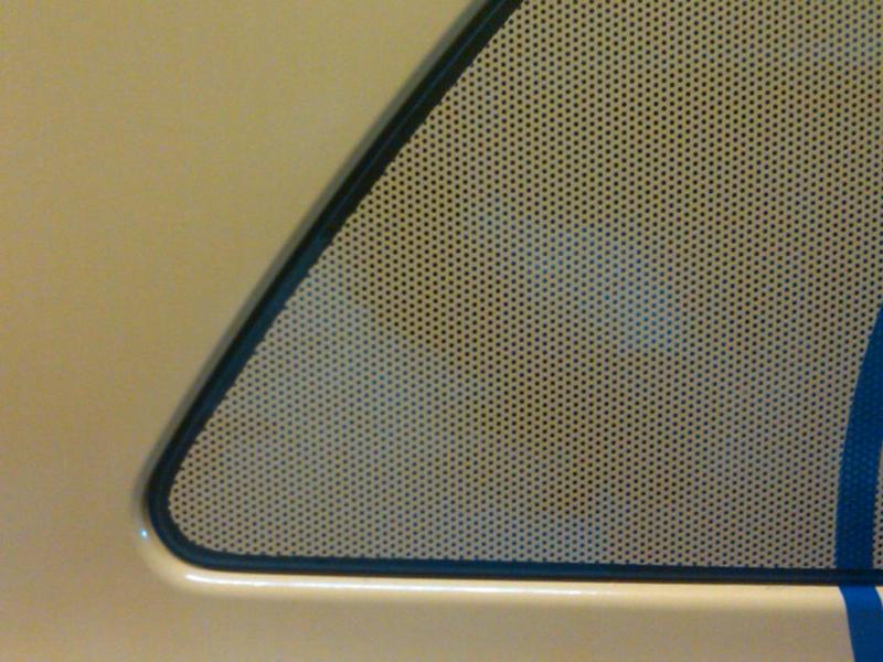

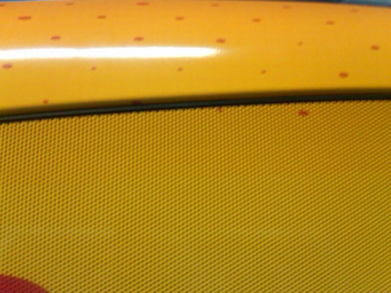

Got some rolls today. My installers love it.
Nice symmetrical cuts like butter and about 5 times faster than the knife. Pics attached.
Worth the $$$.
