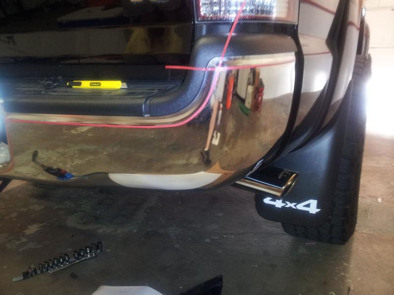

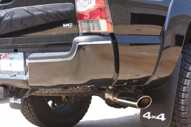

Used WrapCut on this bumper wrap we did last week. Worked great, as usual :)
Customer wanted to show some of the chrome as an accent, so WrapCut made that pretty easy.
