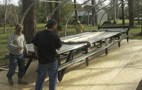

...also here's bad pic of the thing (unloading). the gantry will do the traveling.

Artbot how do you keep this thing level, sitting on plywood just sitting on the ground? I would think you would want at least a framed flooring system, on some type pier system.
artbot
it's in a temporary shelter (weatherport.com) the floor is just something to walk on for the year while we get our building figured out a the back of the property. the table has risers on each leg so i'll just drop a laser across. i'm not sure the table will even be printing that much before it leaves the building. i've got two or three other custom/top-secret giant gizmos to build that go with it.

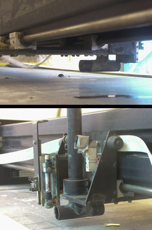

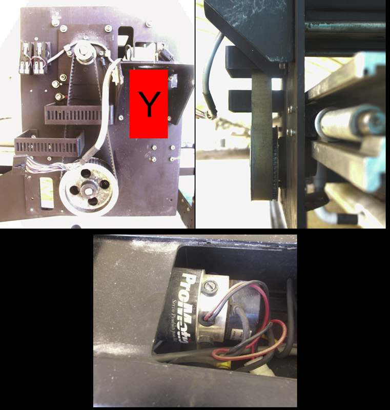

here's some close ups. i'm sure the linear motion side of things will not be an issue. the table looks over built and the tolerances are very tight. such as on the gantry there are two linear slides, the whole carriage is locked in with "0" budge. not nearly as sloppy as all the printers i've had.
it all comes down to options. having a custom carriage means i can achieve endless speed upgrades. but i need to keep it super simple first. i could probably stick a novajet 600 on it and start making money.
i'd like to get it printing for $10k. for that limited budget i'm stuck with sticking an old mutoh 87" over it. if i go $18k i can do something industrial. also there are lots of $10k 82" dx5 chinese eco-solvent printers out there which look tempting because the parts are so cheap. i figure machining/motors/misc will run $3k.
