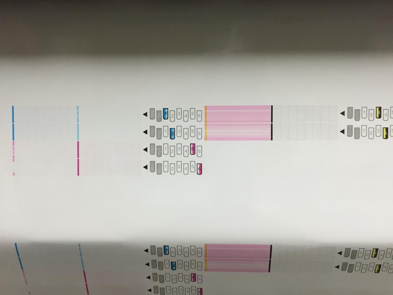

We just purchased a used l26500 and I was setting it up today and I did a test print. It looked pretty good for the first 4 inches. After that it looked bad. I did a test print of the print heads and one head was out... The other was printing magenta where the yellow should be... Any helpful tips? image.jpg image.jpg image.jpg
eahicks
Looks like your yellow line is feeding magenta ink....is there any chance the wrong in the slot? I don't know if that's possible on the HP.
MikePro
it's supposed to do that. if you look close enough, there should be yellow lines in that magenta band. (i believe it is done this way because it is IMPOSSIBLE to see yellow nozzle testprints on a white background)
your yellow ink is flowing just fine, and printheads firing as well, as you can see your fill on the #3/4 markers that also printed with the black...aside from trying to see the nozzles in the magenta band, as stated above.
you do need head replacements, however. particularly the #1 & #6 printheads, where you can clearly see a hard line of blocked nozzles in the test prints.
you can always try to run "clean printheads-mode" to see if you can recover some of the nozzles, a few times if necessary.
You may be able to limp-by on simply replacing just those two, buuuuut since you purchased a used machine you may be best off just replacing ALL of the printheads and starting-fresh.
Its a few $$$'s but you'll know that you're printing the way you should be off the get-go, while you can better spend your time obsessing about alignments/profiling/producion/making$$$ off of your new investment.

Thanks for your help. I thought something was wrong because the first test only had yellow, I assume now the reason was because the #6 head was completely out. I think we got some heads in today so I will give that a try tomorrow.

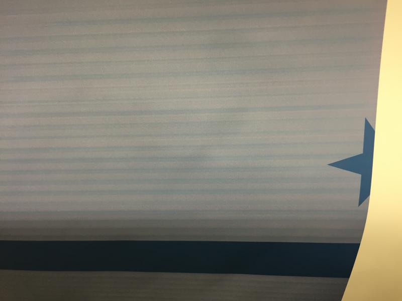

So I got it up and and it was printing beautifully... So I decided to run a wrap over night... I checked it after 6 ft... Printing great. Checked it before I left... About 8 ft in and really bad banding. I replaced the heads and they looked great befor I started the print. Is there a setting in the printer to adjust how often it cleans the heads? If that is the problem? Any suggestions? image.jpg image.jpg
So I got it up and and it was printing beautifully... So I decided to run a wrap over night... I checked it after 6 ft... Printing great. Checked it before I left... About 8 ft in and really bad banding. I replaced the heads and they looked great befor I started the print. Is there a setting in the printer to adjust how often it cleans the heads? If that is the problem? Any suggestions? View attachment 103188 View attachment 103189
That certainly appears to be nozzle-related. The proper procedure is:
1. Run the Nozzle Test Print (under the Image Quality Maintenance Menu > Clean Printheads > Print Test Print).
2. Based on the results, run one or more cleanings to attempt to clear the affected colors
3. If the head(s) cannot be cleared, replace the head(s).
Also, be sure to properly replace the ink cartridges as they run out of ink. Do not force the carts out when they are pressurized. Initiate the cart replacement from the control panel of the machine. Otherwise you can introduce air into the ink lines that will result in severe banding similar to what you are seeing. air in the lines causes a 'fry fire' where the head is jetting air instead of fluid, and this in turn is very bad for the printheads.

When we were moving it around one of the inks popped out but I would have thought that after 16 feet of printing any air would be out of the lines... But that is just a guess. Is their a safe way to make sure the lines are flushed? If that is the problem?

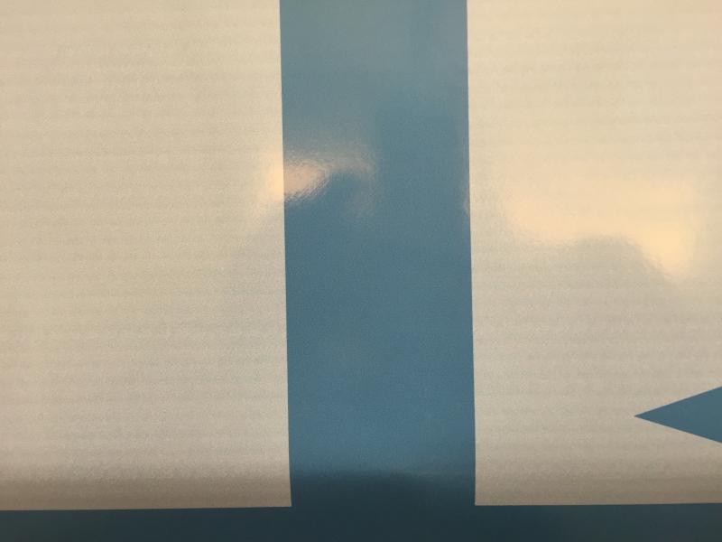

So this morning I'm working on it again and the test print looks perfect... But the light blue still looks horrible. Any ideas? image.jpg

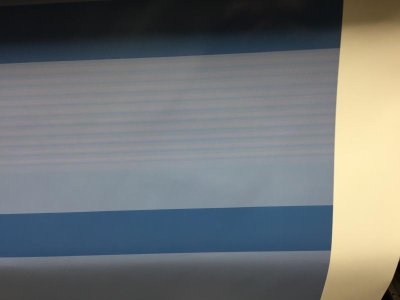

So frustrating. In the middle of a print one color goes out! Last night one of the light cyans would disappear this morning one of the light magentas went out! They are new print heads. Before I start printing I checked them with a test and it prints beautifully. I don't get it.

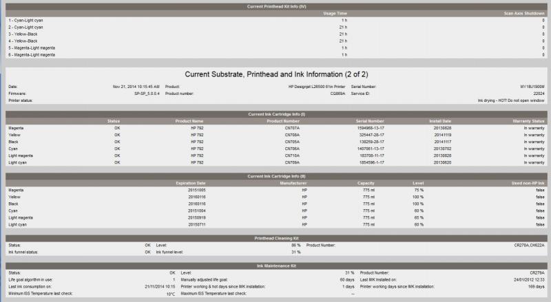

Log into the printer via the web interface and look at the head usage. Post a screenshot. You certainly could have air in the lines from the cart that popped out, or more than likely you just have heads that need replaced. Again, post that screen shot, it's the "support tab" on the web interface then "printer information"
If the heads have shot a lot of ink, they may be misfiring once they are heated up and have printed for a few minutes, might explain the after 10' dropout.

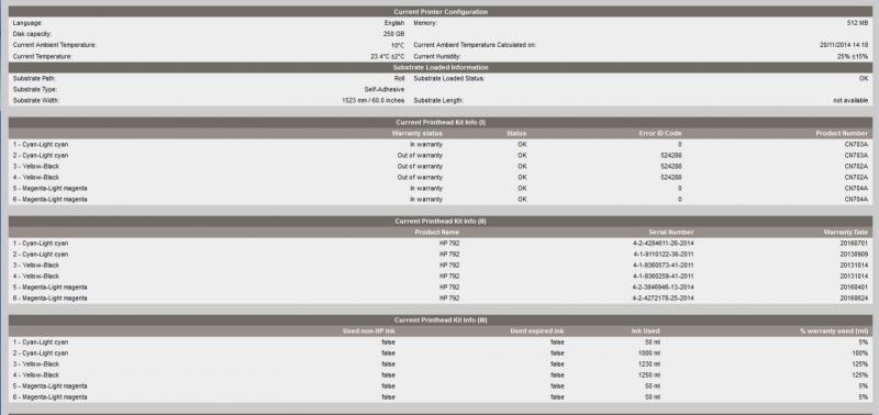

hp1.jpg hp2.jpg I replaced 3 of the heads, 2 Magenta's and a Cyan yesterday afternoon. Last night before I left the lt Cyan one head went out on the head that I had not replaced. This morning the Lt Magenta on 5 went out. Also when I went to switch out one of my inks, it has come up with an error on the black cartridge... after I took it out and put it in a few times the error went away. Is that standard?

Is there any chance the lines could be clogged and not letting the ink flow? I would think that it would have already pushed enough ink through the heads to get past that problem. I installed a 2nd new Magenta head and now there is a line in the Magenta. Brand new head.
It was running 5.0 firmware and I updated it to 11 so I will give that a try.
