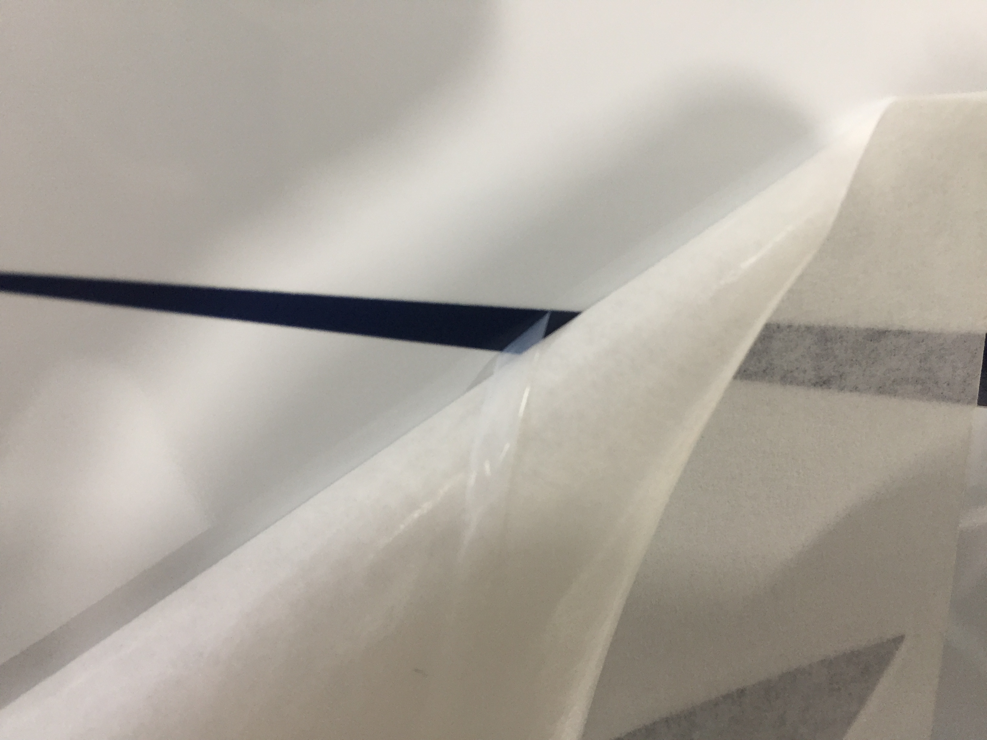

Im getting same issue with Oracle's 5600 reflective and there 290F laminate, on a latex 365 printer, the app tape is pulling the laminate off.

Sounds like possibility too much optimizer usage. I have never seen it and on vinyl I use 8 to 12 optimizer setting.
What setting are others using?

Obvious place to start is to do a sample with no optimizer and see if the adhesion issue is rectified.
I would slow down the print and run the heat at max to ensure everything is dry and baked before laminating.

The problem lies in the scratch resistance fluid that rises to the top of the latex ink during curing that creates a barrier preventing full adhesion. It's across multiple vinyl brands so it seems to be the Latex Ink which is the issue. Reducing the number of passes helps...but on reflective, that will be a problem. Reflective needs more passes.

Increase in passes lays down more ink, thus having more of the liquid that is causing the problem. I don't think the dwell time is the issue, but the ink levels may be.

I'm pretty sure(99.999%) on the HP latex 500 series the number of passes does not determine the amount of ink that gets layed down. The amount of ink is determined by the ink density.
I don't think that it's just the heat setting, but also the number of passes, ink density, optimizer levels and these differ with location and material. As far as the profile I use theirs and than tweek it to suit our needs.
