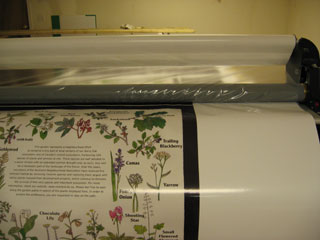

Lamination Issues with picture!
Okay here is a picture of what happens. I have tired every way I can think of to get both sides to have equal pressure but to no avail this happens every time!! It's soooooo frustrating!~
Please help me !! I'm a laminating loser!

do you have the laminate webbed correctly?
the laminators that I have used do not go directly from the roll of laminate to the application rollers, they have a smoothing roller or rod on them before the application rollers, I dont know if your's has this or not but this is how mine is webbed, //chopper

I am no expert believe me but I found that when the lamination started to look like that photo we actually had to much pressure, since releasing the pressure that problem has vanished for the most part but then again I don't run 15' prints either

That photo does look like too much pressure. Be sure never to stop the rollers once you have started.

We had the same problem with laminated becoming wrinkled on the top roller. It was caused by the top roller not being level, which created more pressure on one side of the laminator. We had our dealer in with some special tool that looked like a fish weight scale (there was a really thin piece of metal on the end which was run through the laminator ... the scale would register the pressure from the rollers pulling on the metal piece). After a few adjustments to level out the top roller everything works OK now. (We have an RS 1400C laminator). Hope that helps!

Have you called Daige? We had similar problems and a part of the problem was the bottom roller. The new ones have a slight crown in the mddle. Our solution was the new roller and using 1/4 plex for sleds. On long prints we needed 3 of us to keep it running, and moving sleds back to front for long prints. We also made sure that we did not let the print bunch up on the sled by slightly lifting the end of the print to put a little air under the print. Carefully check your pressure, and run a starter board thru first to be sure it is going strait.

Looks like roll of laminate doesnt have enough tension, That is compounded by the print not going into the laminator flat.

I had the same problems with my daige. The rubber on the bottom roller was twisted. I called daige and they sent a new rubber sleave for the roller. It was a pita to change but it seams to have fixed the problem. I ran a 15' print threw it last week and it worked fine. I have 13 - 8 foot panels to run through it later today, I guess I'll see what happens.

another trick is Dock the corners of the starting edge of your print. leave enugh excess material on the leading edge to cut the corners off at a 45 Degree angle. about 6" off the corner will do. this helps ge it started better. also once it is started do not touch the material. if you apply drag to one side it will start to feed up like that picture shows. if you get the print in crooked and unter tention there is no saving it, that print is wasted.
Make sure the tention down pressure is even on both sides. if there is more down pressure on one side it will pull to that side seeing the result you showed in the picture.
