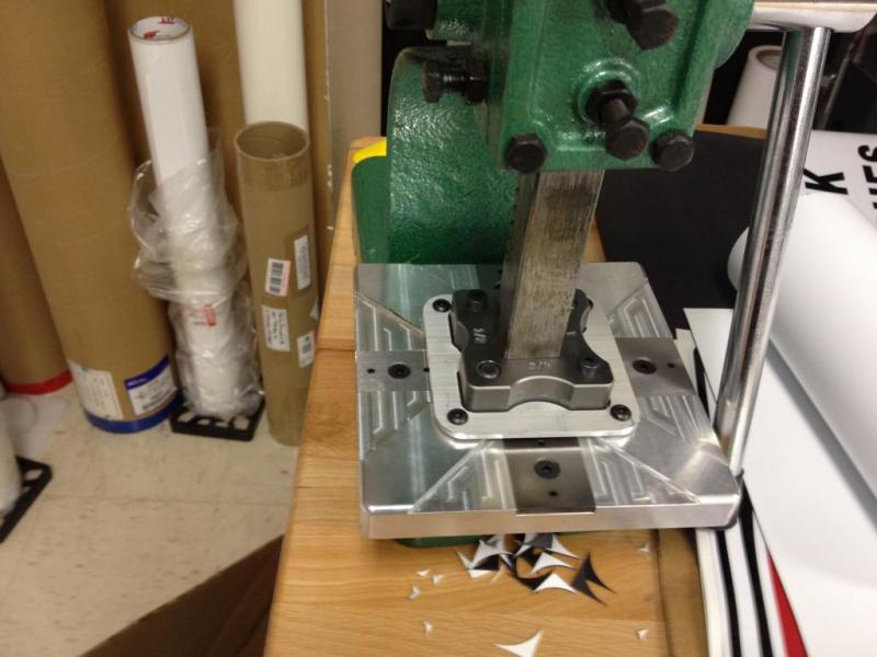

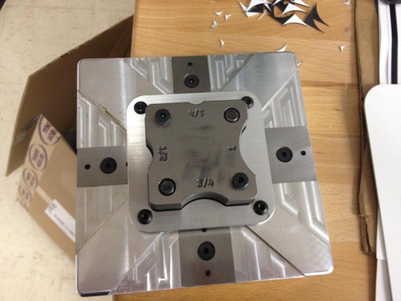

I have the 54" Seal EL I am happy with it. Very Heavy well built machine. on another post you were looking for a corner rounder. It would not allow a comment on that post but you may want to look into this. it cuts up to .090 aluminum and 1/8 dibond. add a 50 dollar arbor press to the 350 price and you have a rounder that does 1/4", 1/2, 3/4, and 1" I have been using mine for over a year it works great. I found mine on Ebay but think the guy has a website.
