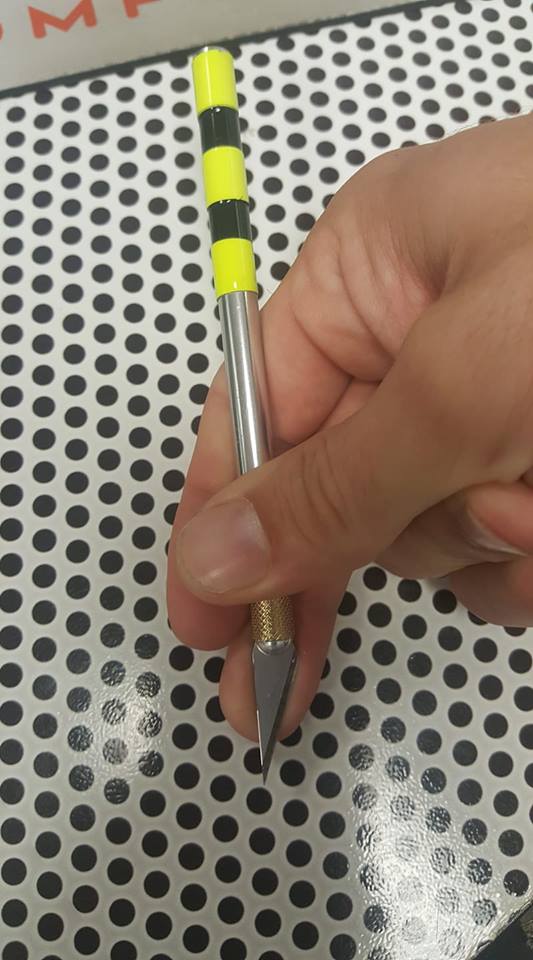

I stick my finger alongside the blade on an exacto, leaving about an 1/8" blade showing. Rub finger directly along material when held taut.

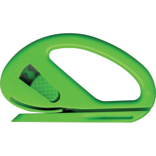

a zippy knife is all that is allowed near our laminator.
