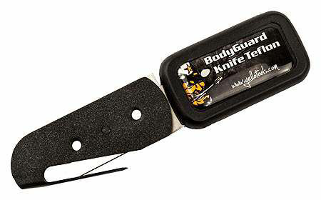

a zippy knife is all that is allowed near our laminator.
We have a couple of those, but I don't like them. I prefer the body gaurd
