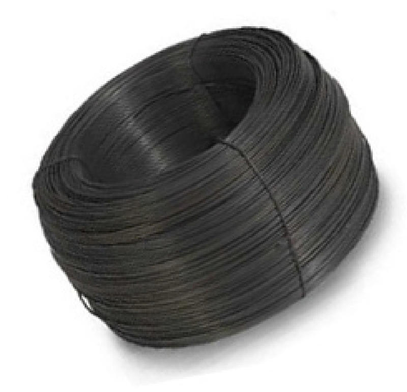

When I say tie wire, I mean like the stuff in the picture, it's used for many different things but mainly to tie rebar together.
You can find it at Home Depot in the area they sell their concrete, it's around $5 a roll.
I'm assuming that you went with a mesh with the larger holes...If so, the wire will easily fit in those holes.I would only use this on the top, lace it , going through your banner and around the top horizontal post a couple of times and then twist the wire ends.

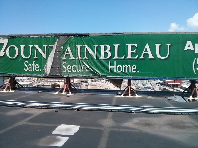

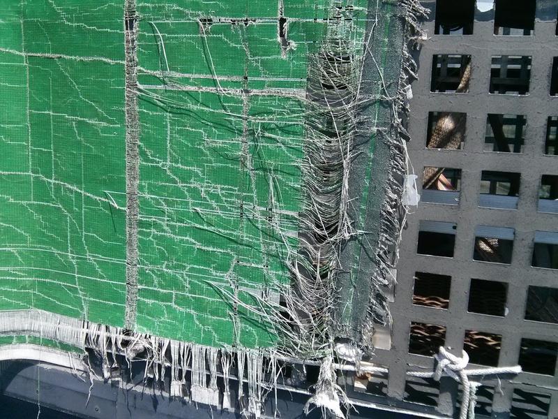

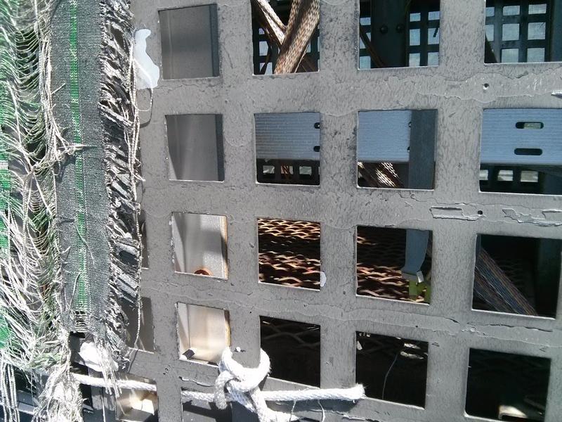

One of our clients wants us to replace their 10x100 feet banner. It will go on a roof of 8 storey building. The images are attached.
Do you think a mesh banner and stainless steel zip ties will make it?
What would be options for a permanent sign that big?
Thank you.
In my case, I've finally went with 2 stainless zip tie + 19ga stainless steel wire. I know, it's overkill but the customer wanted to be 100% safe. If it were just me, I would go with the 2 stainless zip tie.

I can't tell if there is webbing on that or not...is there? there should be.
