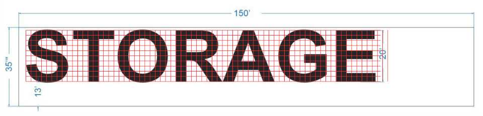

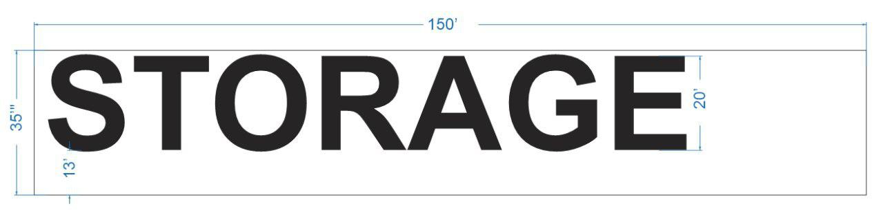

We are looking for some guidance on how to best execute a very large scale wall mural project.
We have been asked by our client to provide some sort of stencil and they are going to paint the mural themselves. We figure because of the scale, a good option would be a projection system.
Does this seem like a good route to go? There is a drawing attached with measurements.
If it does seem like our best option, can anyone give a description of equipment used, logistics of the project, etc?
If you have a better idea on how to get this done please share.
Thank you for the help.

Projection may work if it can be set up correctly. A scaled sketch with a grid works too, probably the way I would go. And I have actually done some pounce patterns that big, usually not for something so simple though.
  • Is it just the word storage ??
  • What kinda wall ??
  • What texture is the wall ??
  • What kinda paints ??
  • How high off the ground ??
In all honesty, that's something which should be drawn out by an actual person who knows what they're doing. Most likely a grid approach/setup. Ya cut in the lines and then just roller the insides.
We did one about a year ago, something like 28' tall and about 50' wide. A commercial painting company did the work. We just made a pounce pattern, they pounced it, then painted inside the lines..... like a coloring book.

How do you make a grid? Laser level + chalk? We have a Summa Cutter 54" that can cut through material. I'm sure it can pounce too. How would you attach paper or vinyl 20' long to a wall? Blue tape? Staple gun?

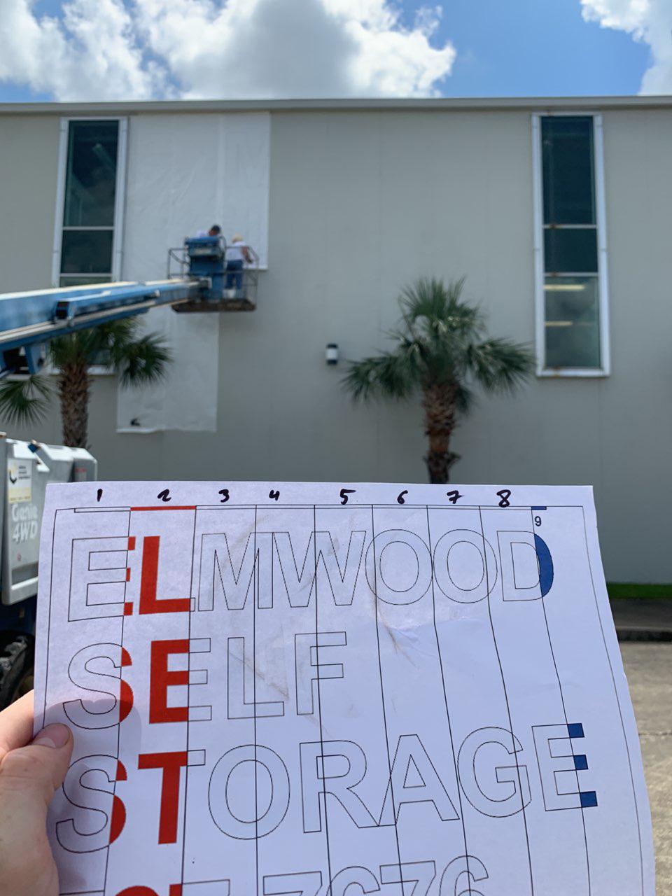

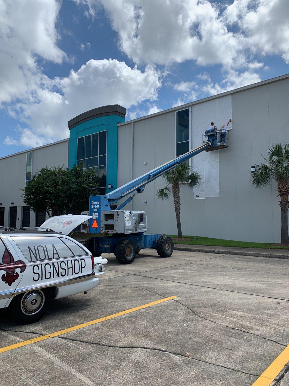

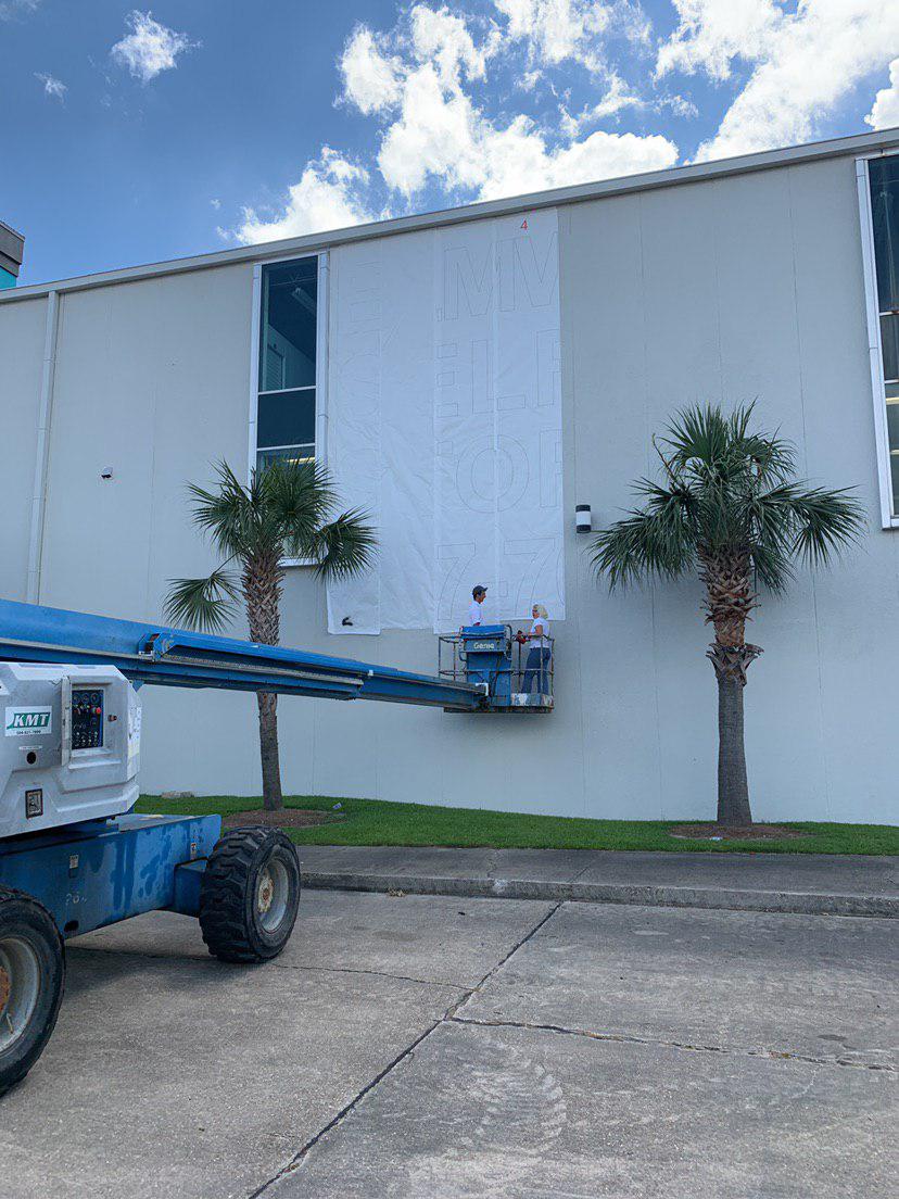

We ended up printing the outline on a butcher paper, used the pounce wheel, battery stapler and rattle cans.
