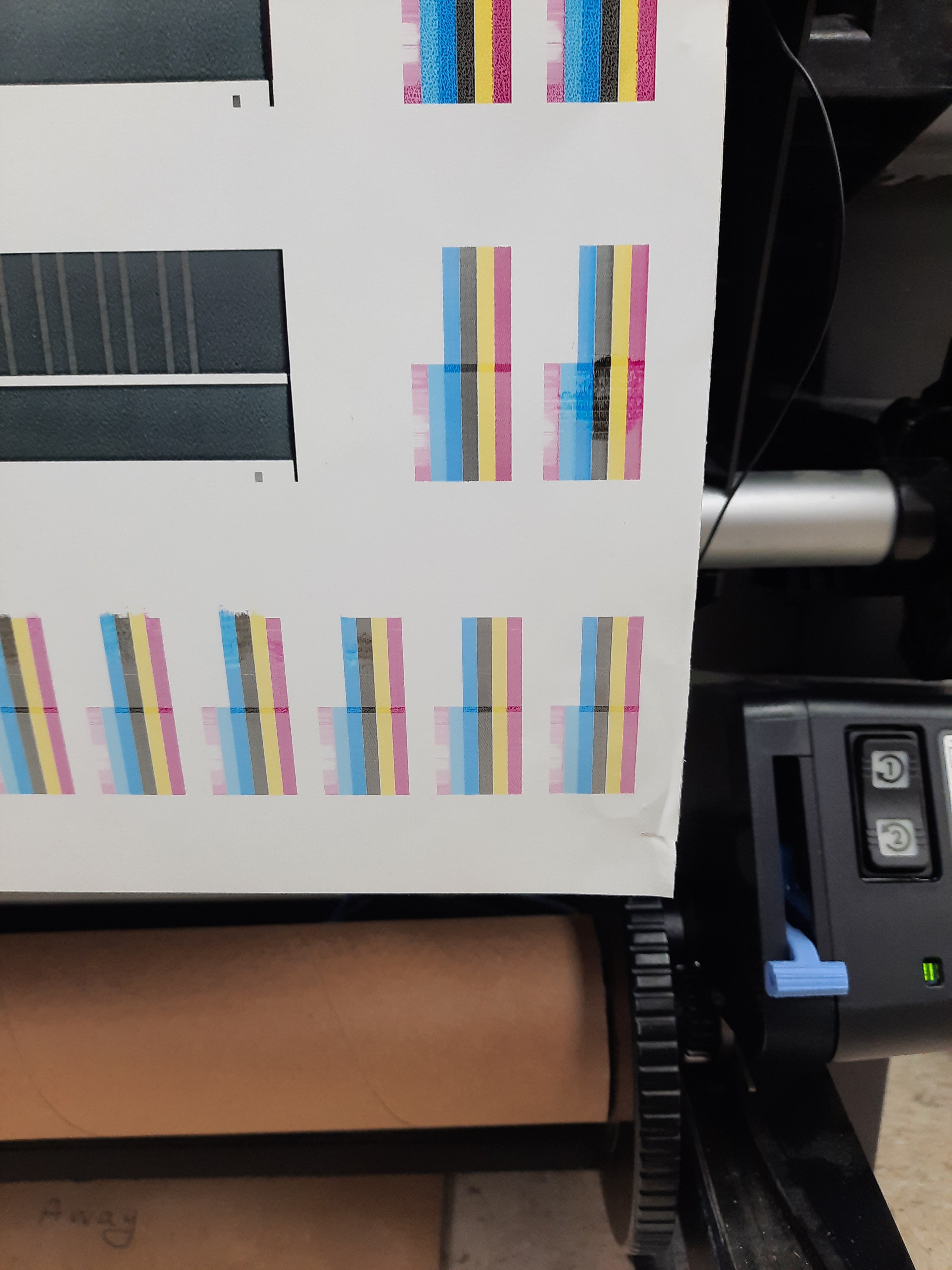

I replaced my LCLM printed head a month ago, in Monday this week it was causing streaking in my prints. I replaced it again, now it's Friday and the same thing is happening with the brand new print head. Not sure what I can do to fix this other than having a tech come. Any ideas ?

I would definitely start with replacing that LM cartridge. Them maybe insert one of the older printheads and do a bunch of LM-LC cleanings to move some ink in the line.
Purging the line by syringe would be best but maybe 20-30 cleanings would do something similar. Only then try to work with the newest printhead again. Which you also probably have to clean bunch of times to get the air out.
