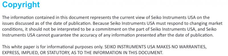

I read that same document prior to my purchase of the HP26500... it is, to say the least, a bit biased in their claims.
they even go as far to add this in their fine-print:
attachment.php
they could have documented that their printed Snozzberries really DO taste like Snozzberries, and all would be fine and dandy.
