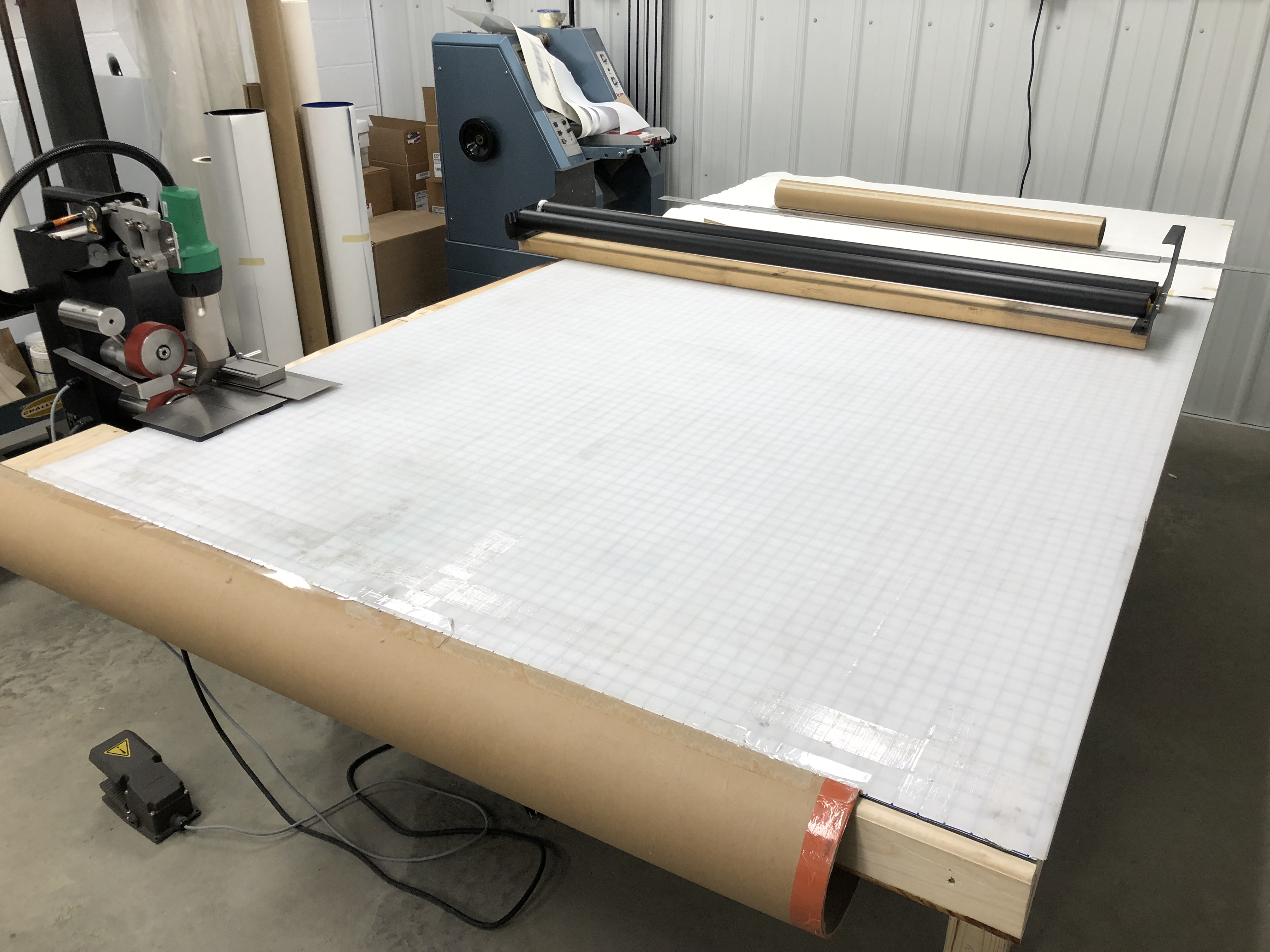

    I'm curious as to the table you are using for the welder. We just bought one and have attached it to the sewing table temporarily until we build one. We were thinking of a 10'x3' with a glass top or laminate top to help slide. The glas wpuld be good also for someof pur fabric hot knife.
    Bryce, what type of table do you guys use?

    We built our own table 5x9' and then put a self healing mat on top. We made a portable roller system that sits about 2 feet from the welder on the table that then lets rolled up banner easily unroll and feed into the welder. We then cut up a tube that housed the banner material for shipping and put it at the end of the table next to the welder so that it could roll off the table nicely or be pulled back up without it scratching the banner.
    It works great but it can become a hassle on the 25' banners having to roll it back up after it unrolled but I think it still works better and faster than trying to drag it across the table - too much friction to keep the wide banners slowing smoothly.
    I can post a picture if I can remember when I get back to the shop.

    Please Post pictures of your table I would like to see your setup thanks

    The roller system is sitting on the table in this picture, but it is stored under the table when we are doing smaller banners or using the table for other sign work. The welder we just leave permanently attached to the side of the table. When we built the table, we made sure that it was the same height as our laminator so we can easily pull prints off after laminating, or easily run acm, alumalite, or any other signs right from the table.
