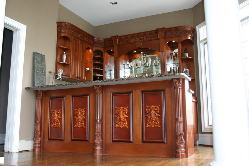

james mcgrew
hello, my name is james mcgrew and new to this forum yet not new to forums, i bekieve this started as to defining resolution and jerking on a cnc, this is adjustable and most cnc fabricators know little of the end users needs for this, a sign cabinet company cutting rectangles would probably never notice this however one cutting arcs or 3d would.
cnczone.com has other multicam operators and you may have to learn more about your controller software than you probably intended to. the company i purchased my cnc's from uses wincnc controller with it we can be online live with the tech within minutes with him running my machines from georgia after a bit of initial setup and adjustment we very rarely need him any further, on another note they have never charged us for this. check in your program file and see if you have an .ini file in your controller file?
see if you can find what type of controller they are using, ther may also be arc settings in the software (lots of nodes) that can cause jerking as well. we use aspire and most of it (jerking) was in our controller commands
jim
