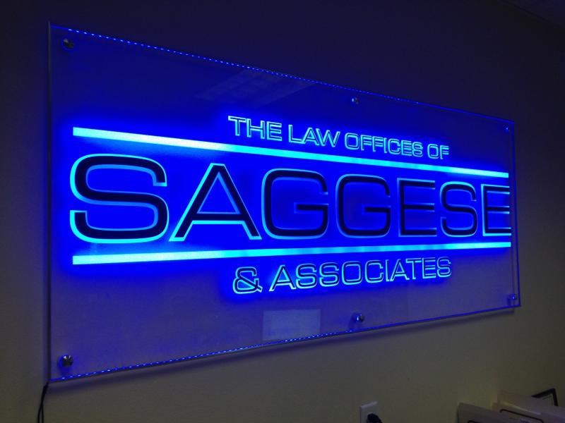

So just an update if anyone is still following this thread. We got the project done and installed it today. I have attached a picture for you to see and it looks amazing.

Looks good.
An extruded frame is a good way to hide the LED's. A 1" deep frame, ½" at the bottom is for the LED strip to sit in, the other ½" is for the acrylic to sit in.

that looks great! such a cool and easily added effect for a sign, engraving the glass/plexi to catch the light.
I was going to reply that you could go with LEDs, to keep a small profile, but then realized you were posting the completion photos from the OP :)
...aaand that, if you used a LOT of LEDs, you could go BIG!

We ended up buying led strips from lumenedge.com (I give them many :thumb: for customer service) 2 of them one on the top and one on the bottom plus two reflective strips on the ends to give it a framed look. We found a local guy who had closed his business but still had his laser and did the etching for us then we laid cut vinyl letters on the front had the edges polished. Yes this was our first edge lit and it is large 6'x30" would never do one that big again if we can avoid it but WOW what a great effect. Everyone was awed by it when we finished even our installer/sales guy who has been looking at the thing for months as we worked on it.
