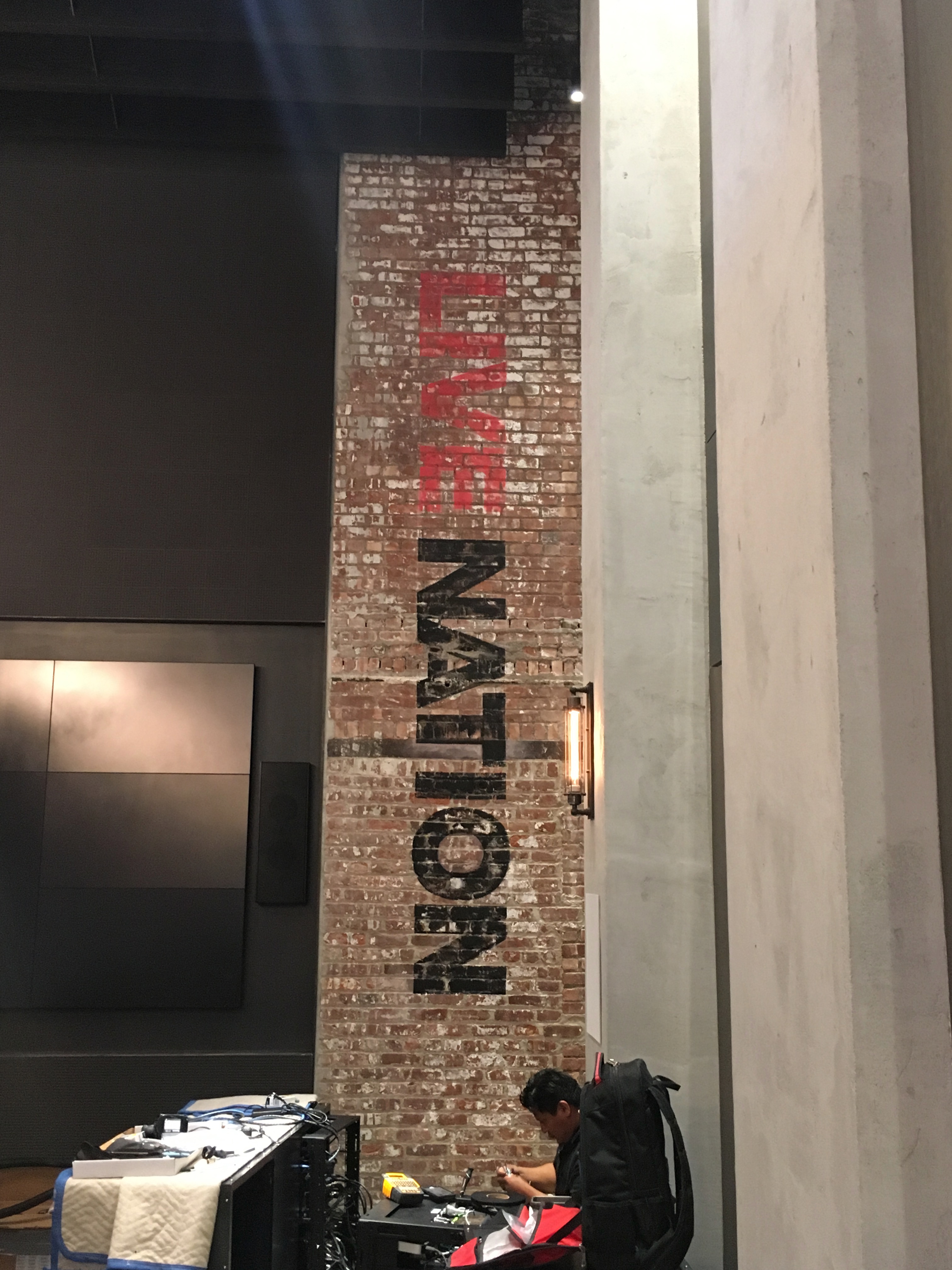

    Rob,
    I do this almost every day. I use Benjamin Moore Aura or Low Lustre Exterior.
    If you are a sign painter, you can paint the letter as you would, cutting in the outline, but leave gaps in the strokes. Fill in sketchily, leaving exposed brick within the letter. Paint will wear off a wall in unpredictable ways, so you can be playful.
    Try not to fall into a pattern.
    If it makes sense, a stencil can help with the outline, but I find it easier to just do a hand layout.
    Have fun!

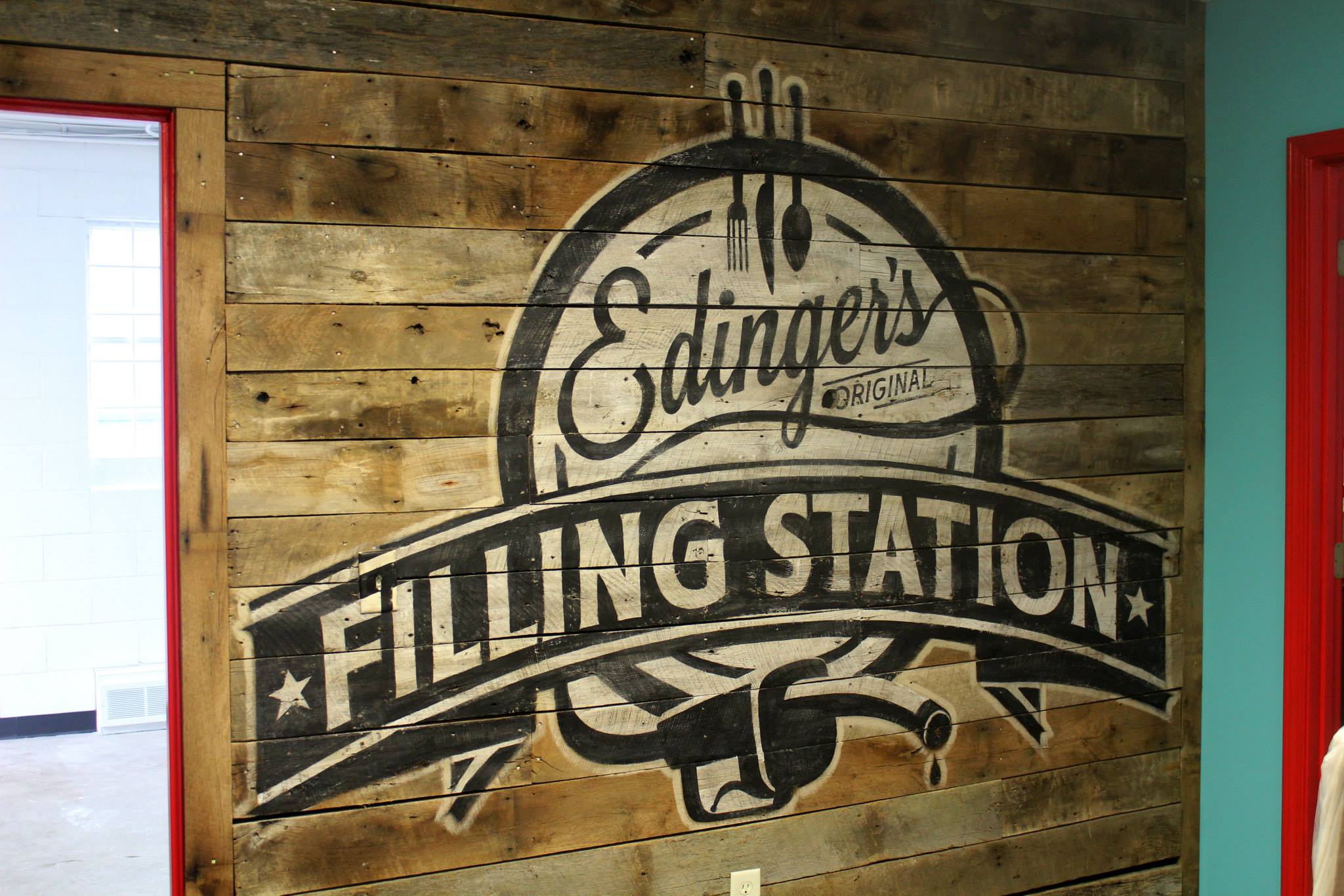

    Having it done by hand with paint sure is going to look a lot more authentic. And making it look vintage by hand isn't that difficult especially if the the surface is rough. In fact, not having to go back and do multiple coats and just letting the brush strokes show speeds up the process. Digitally you have to do more work to achieve what happens naturally with a brush.
    Here's one we did not too long ago:
    To answer your question. We did this with Nova Color Paint. I wouldn't use a stencil, but you could project the image with an overhead projector or use a pounce pattern Some plotters even have a pounce setting ;).
