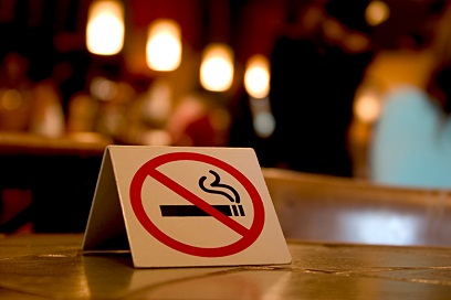

    I have a bar that wants these but they want me to put their bar logo and out for a smoke spot saved.
    Anyone know where i can find something like this but blank.

    You do realize you can make these yourself for next to nothing, unless you need 100's or 1,000's. At that size, you could get rid of a lotta off-falls.
    Get a heat strip, heat up some pvc, drape it over a form, then decorate it. We do many a month of various sizes and degree bends.

    +1
    exactly what we do

    +1, http://www.briskheat.com/p-152-rh-plastic-bending-strip-heater.aspx

    could you bend them out of aluminum? I have lots of srape I would just give you.

    You can score aluminum and bend them

    Yeah i only need about 10 - 15 of them.

    Just use a heat gun, Make a form, can be a sheet of Aluminum bent to the right angle. Heat the bend area and press to shape.

    Yeah, PVC or styrene and just use the heat gun or hair dryer. Nothing to it.
