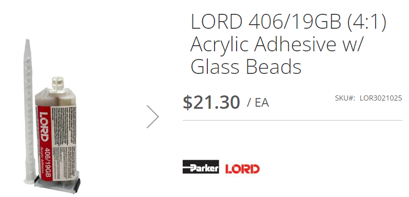

I don't really understand why the GB option is not more ready available (at least not from Wensco and Grimco) as that sure would simplify clamping.
ETA: GB stands for glass beads - they're in the adhesive and ensure a sufficient thickness

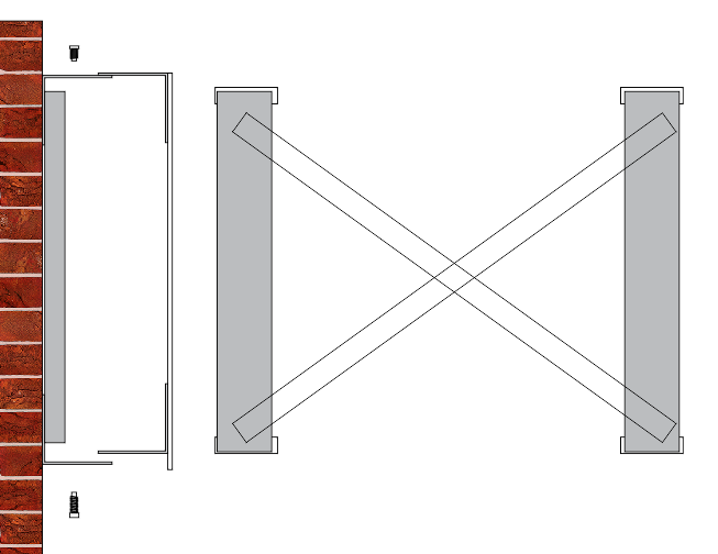

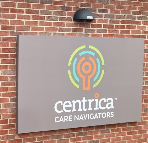

Thanks for your help everybody! Put the sign up last night. First time using this mounting system that I learned about on our beloved signs101! SO EASY

Sign looks nice. :thumb:
Hope its a good neighborhood, so it doesn't get all graffitted up.
So, those angles are what you fastened to the sign and then the lip ??
I believe using .080 and bending the lip outta the face piece, then screwing into the top along a continuous top and bottom rail would've been a stronger and better appearance. You might get a sag, especially if the glue doesn't hold. The sign only appears to be about 45" x 84"', so you had plenty of room for a lip.
It still looks great with what you did, just a bit scary.
That's how we have done it. Mill finish 080, notch 4 corners, brake each side, weld up corners and hit the welds with a flap wheel. Then wrap the vinyl over the lip all around the pan. Make the back frame out of 1/8" aluminum angle welded together and slide the face over it

I ask this with all humility as I'm new to making my own pans and don't have much metal fab experience in general—what part might sag? As for the glue holding, since the frame angle is held square to the brick and the sign "lip" angle is held square to the frame, the stress on the glue is (mostly) shear instead of peel or cleavage so I figgered I'd be safe. Also some of the folks on here claimed it would work fine so OF COURSE I cherry picked the suggestions that aligned with how I wanted to do it :D
