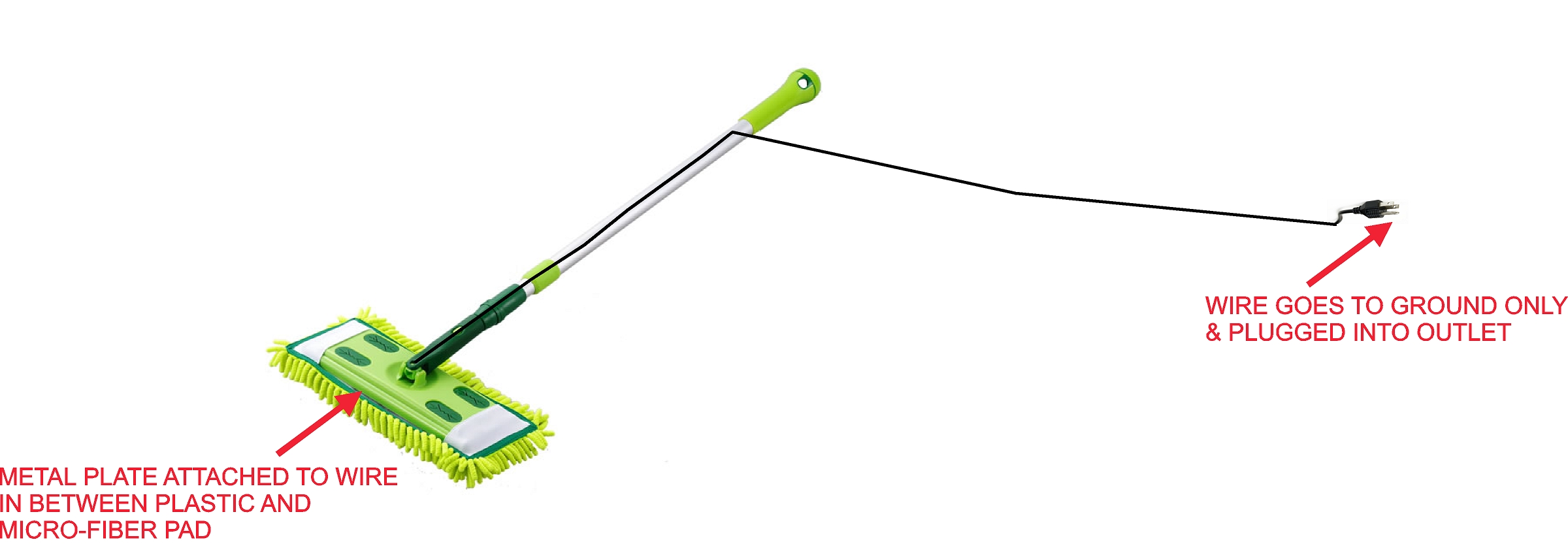

    I made my own anti-static micro-fiber mop, that I would run over the sheet dry prior to printing.
    It's cheap and fairly effective.

    Check out the environmental requirements for your machine and make sure you are within spec. This will greatly reduce static in the room overall. They have those specifications for a reason. You will still run into issue though. The above solutions are great especially Andy D's lol. I have also seen people use dryer sheets to rub down the material and reduce static. If the printer is on carpet, it shouldn't be, you can mix a solution of about 1 to 6 water and fabric softener and spray it around the floor around the machine which helps a little. Check out if Oce has an ionizer accessory. Mimaki uses a device that rides along with the gantry "unstaticizes" the material before it gets printed on and it seems to work great.
