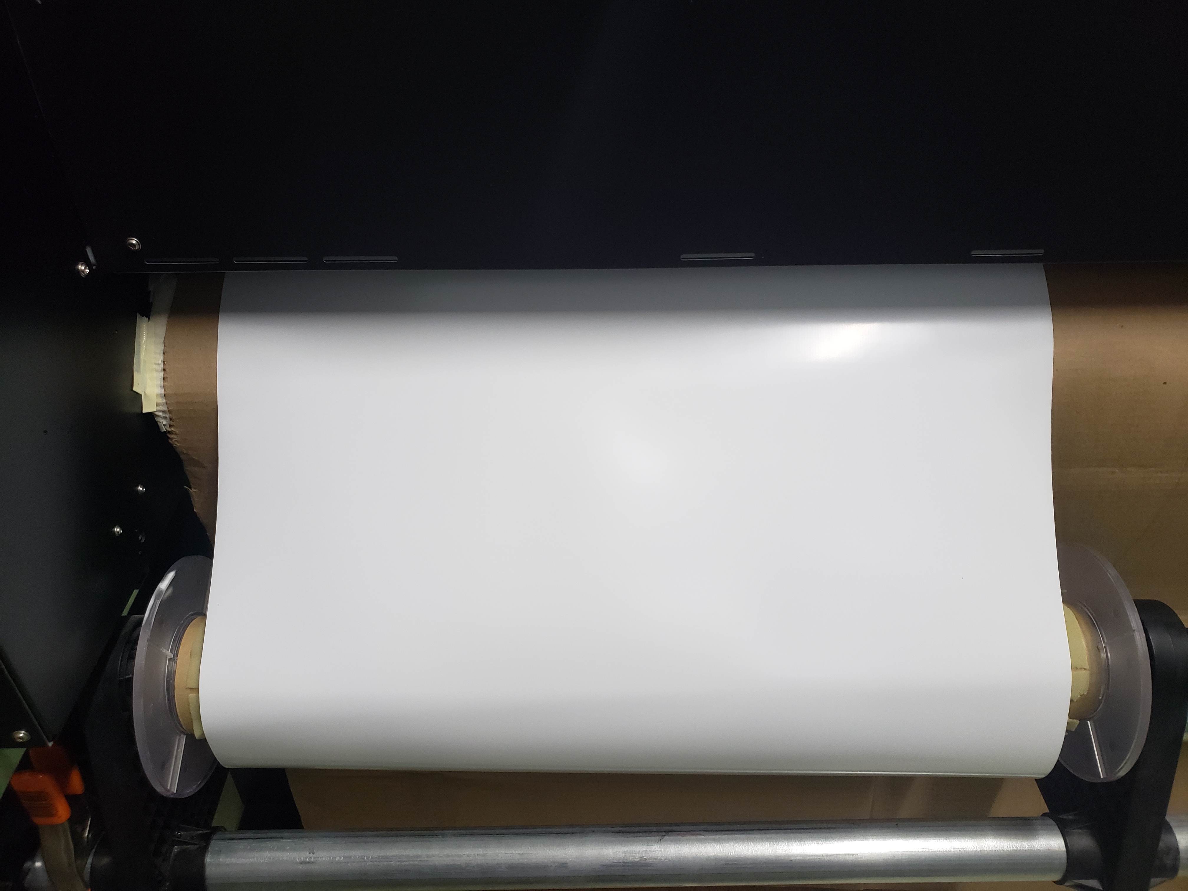

I print directly to the magnet material..
I load a 50' roll of 30" magnet material on my Roland XR640 and start sending jobs.
Each roll yields 650 + - pieces 3.50 x 5.0
I cut it all on a graftec fc2250 within five minutes after printing or I set it up and print roll to roll and cut it all the next morning.

I do not see how the Roland printer easily pulls this magnet roll. That blows my mind. I cut off a cut feet and it literally made me think it was a magnet to something on the machine it was so hard to move back and forth!!! I wish i could see a video of how dang good your setup is working lol

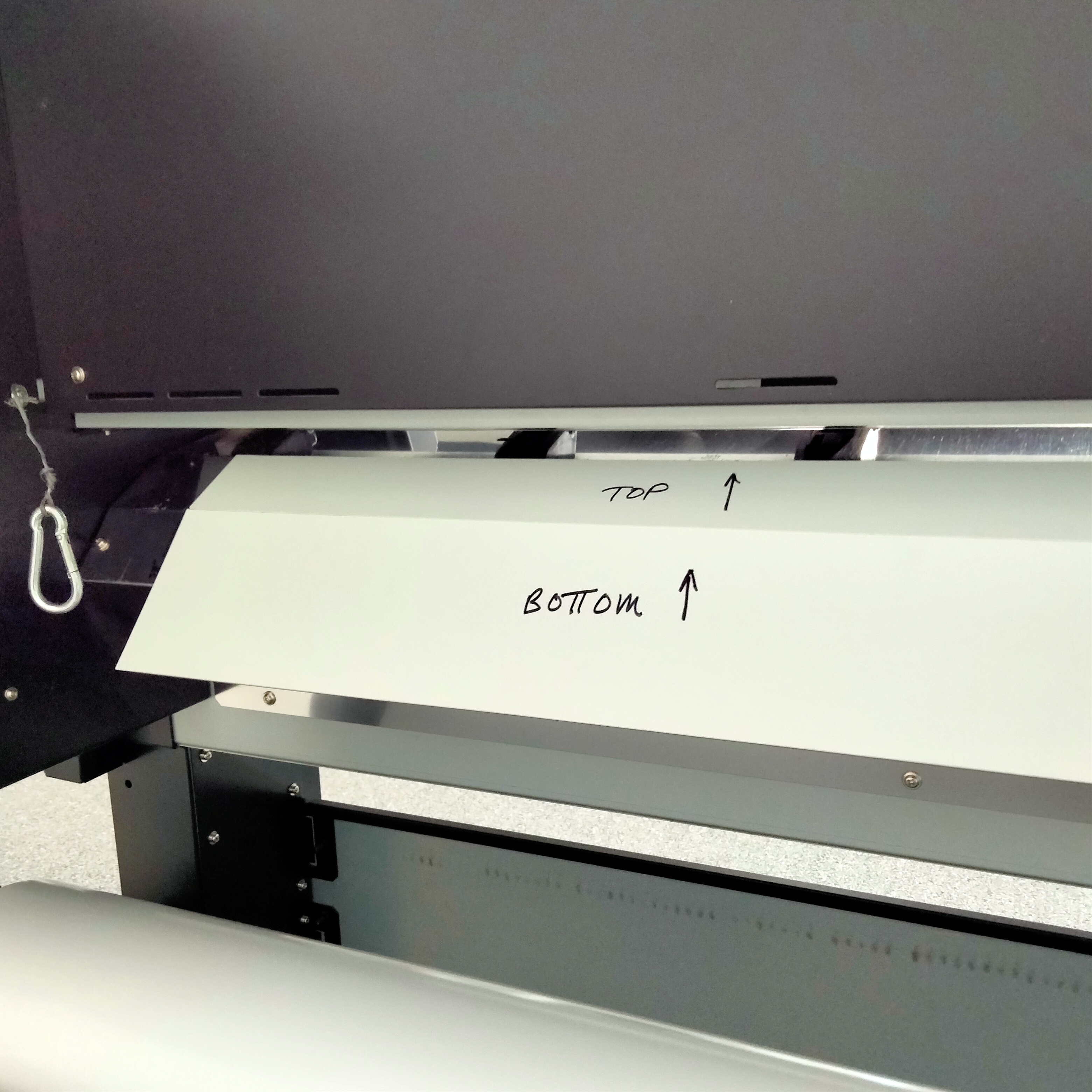

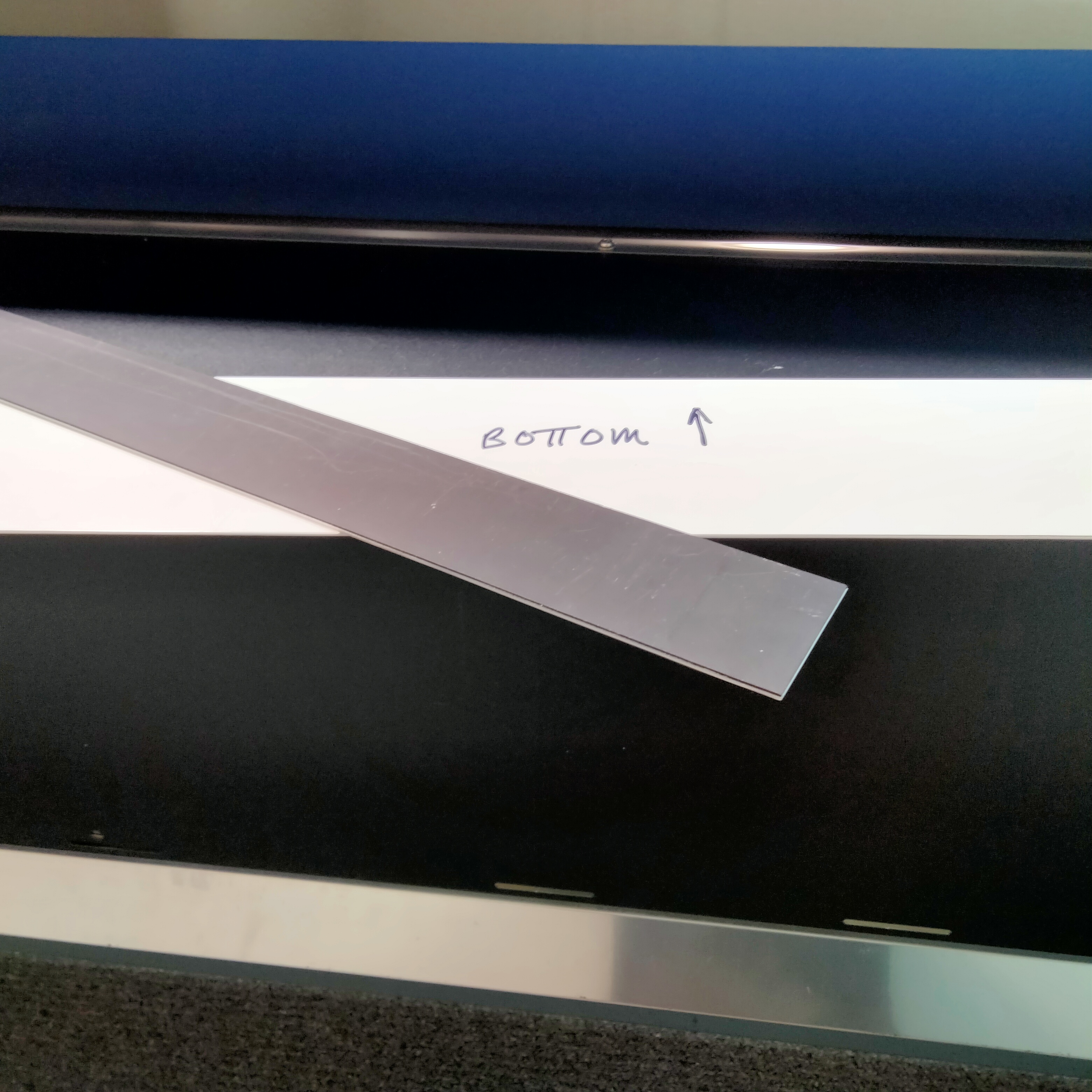

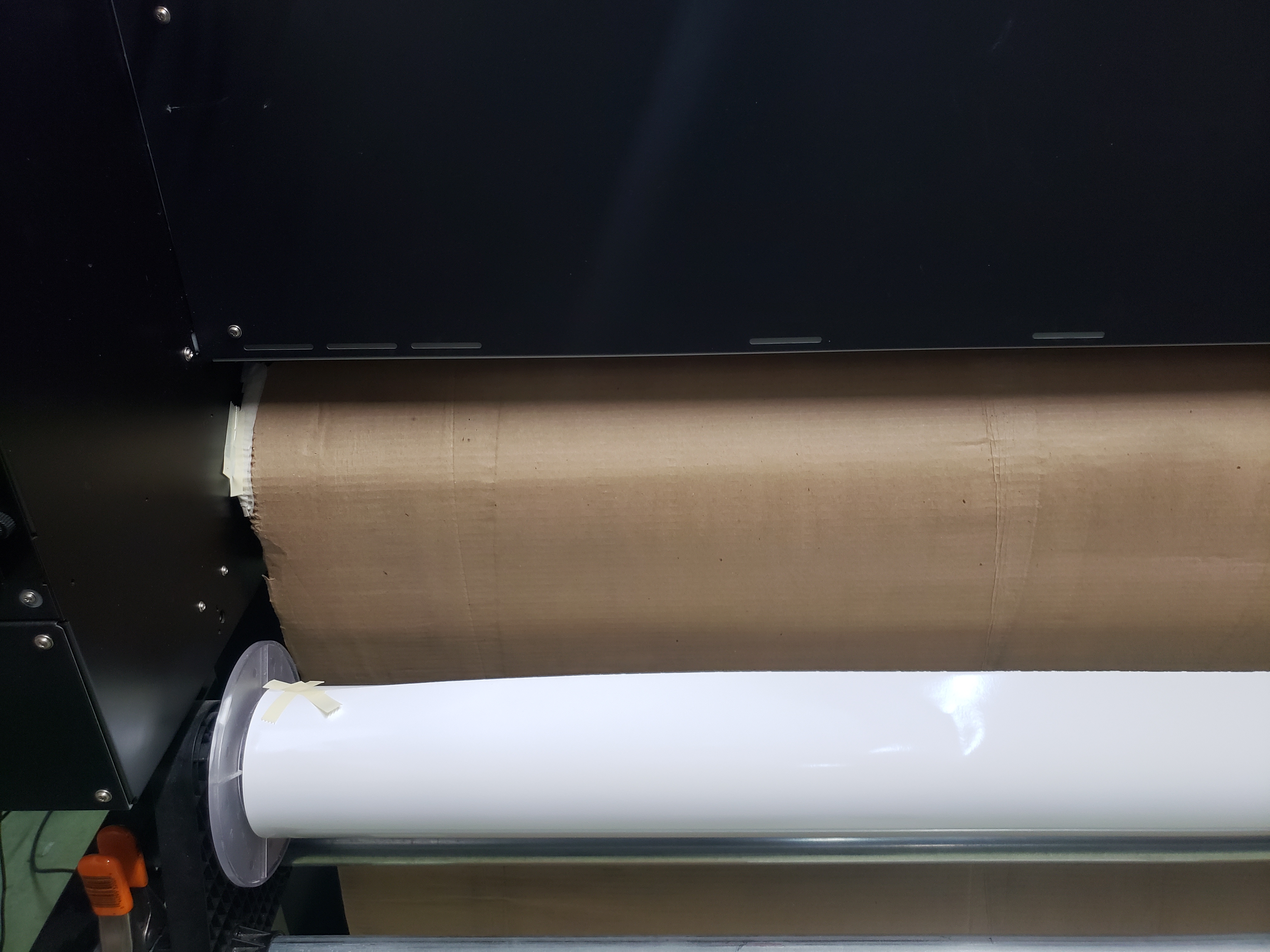

We've printed magnets on our XR 640. What did you do to keep the magnet off the metal platen In the back? We used HIPS, and cut them to fit, put magnet on the back. The roll just glides over it. Generally though, for vehicle magnets, we print on ij180 and apply it to the sheet.
Here are a couple of pics for what we do ..
I attach a thin sheet of corrugated cardboard, ridges facing down.
