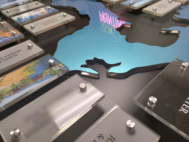

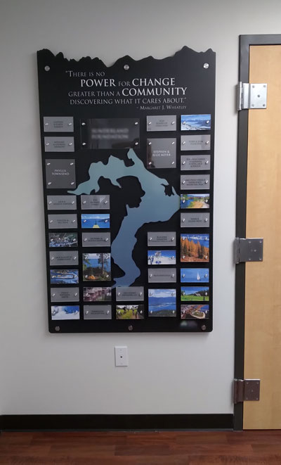

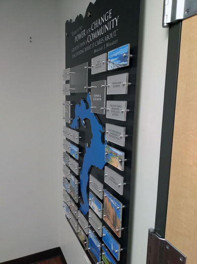

By asking questions to the all-knowing Sign Gods and using the advice, that's how. The display turned out really nice and the customer is thrilled. Thanks to all who chimed in on this thread, including the total dicks, and especially the two members who took the time to speak with me privately and helped me get all the right components together. Here's a few shots of the finished piece, installed without issue. I went with 3/8" acrylic for the main panel, total weight was under 50 lbs. Feel free to ask any questions about the specs and what you may have done differently.
