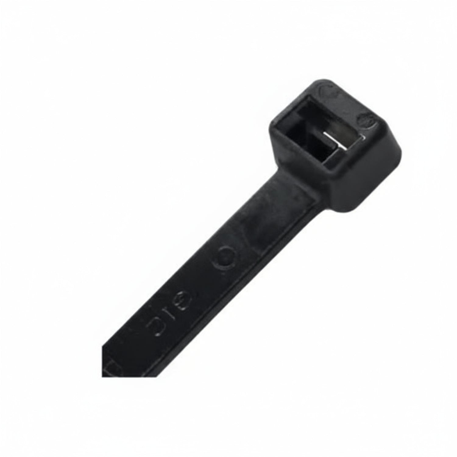

I install mesh banners for a local print shop at area schools. We were using 150 lb. zip ties to attach to a chain link fence, but when a few of the larger banners tore in a windstorm we switched to 50 lb. zip ties on top. Now the school is freaking out because the zip ties tore. Can't win. One school has insisted that we cut wind slits in a one year old banner before we put it back up.

So, you downgraded the zip ties because they held up too well?

After a few banners were damaged in the wind, we started using 50 lb. ties on the top and half way down, as recommended by some banner manufactures. We used a name brand tie, but not USA made. Better to break a few ties than tear the banner. Most of the banners are on baseball diamonds, 40" high. The biggest problems are the tennis court banners at 6-7' high. One fell down in two weeks, breaking the 50 lb. ties.

You have to watch zipties for UV stability. It also seems like the white zipties don't hold up as well, not sure why that is but it's something I've observed.

The banners that are tearing are on a tennis court, 116' x 9', in made in 4 pieces. Grommets every 2 feet. It was installed June 2021 with 150 lb. zip ties. It was supposed to be taken down over the winter, but wasn't. Some of the grommets tore out, and it tore along the hem. It was repaired at a local shop, by adding more tape and grommets, and we put it back up with black UV 50 lb. zip ties at the sign shop's request. Ties broke after 2 weeks. Now we are commanded to put wind slits in it and rehang. Thinking of having them put in grommets at every 1 foot. Might try 75lb. ties to meet in the middle. Going forward, I like the idea of a wind screen to back, but won't that make more wind load?

- 50 pound zip ties... that's about 20 kg, or a 5 gallon bucket full of horse feed.
I wouldn't own something that weak, let alone use that to hold a rosebush up...!
