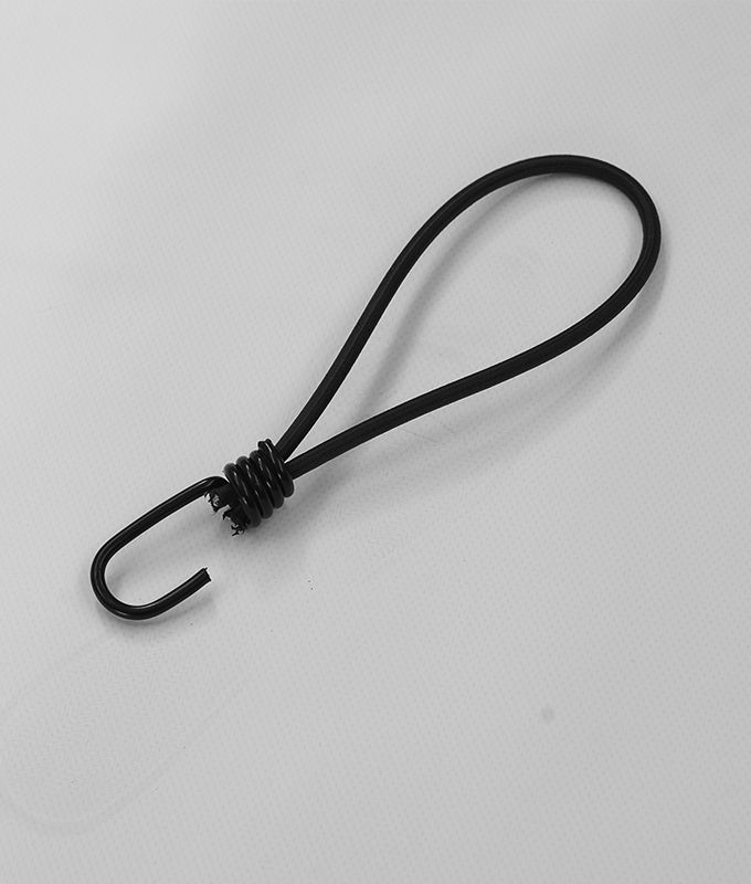

Borge, you're a night owl! Seems the bungees are controversial. Wouldn't the the stretching allow the banner to billow, catching even more wind? Have you tried them? One school is insisting we use carabiners.

We use bungees with Mesh banner.

Bungee cords: some above have scorned the idea, but in the right place they can be an asset.
We used to make pole banners for local towns. There's a big light pole with 2 two-foot long arms coming off 14 feet up, 5 or 6 feet vertically apart, and a plate welded on the end.
A 2 ft x 5 or 6 ft vertical pole banner with a pocket/socket/tube (call it what you wish, a wide hollow hem or seam) is slipped over the top arm, and over the bottom arm.
Because of the way the arms have the end plate, you need slack to get the banners on.
Once 'installed,' they flop back and forth, hinging on the top one, and stressing the bottom one in breezes, until the bottom one disintegrates, or the joining seam gives out.
Putting an eyelet above the bottom, and a bungee strap like used on pickup tonneau covers, tightens the banner, and removes the impact from the changing breezes action on the whole thing. The Bungee gives gently, and resists the 'attack'.
The top is a solid fix, the bungee just removes the overall slop and allows some play in the bottom edge.
It works for us.

Different use, but I am not too keen on bungee cords. A long time ago my brother and I were unloading a trailer at the race track. He went to get the tent pipes loose and the bungee cord slipped - it shot out and around the bundle of pipes and the metal hook caught him right on the outside of his eye. A little closer to his nose and he'd be the one eye'd motocross racer. At least ratchet straps don't try to take you out when you want them to relax.

I too, had one let go when I was a teenager, and fly across the back of the ute (pickup) and clobber me in the forehead like a golf ball.
But there is quality and there is trash.
I'm not talking about using the Five-for-$2 chinese specials that wouldnlt hold a pair of socks up in a line dancing competition, but the UV stable exterior ones made for attaching tonneau covers to the back of vehicles. They last years, in the weather, and are still elastic.
