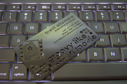

I want to start making metal business cards. There is NOONE locally that makes them and I have ALOT of ppl with interest in them, even after I tell them the cost.
Looking to make something like this...
metal-business-cards-1-1.jpg Offsite pic replaced. Please observe our rules on photo posting.
I assume I would need some kind of CNC machine... Just looking for some ideas to and where to buy, used @ first, Dont want to break the bank getting into something that only takes off for a few dozen people.

My suggestion to you, is that you firstly see if you can get some decent orders, then outsource it to a company who makes them. Hint: these are not CNC machinists - if you use a CNC it will cost you even more to make.
The cutting and etching is performed by the one process, known as chemical etching. It's the most cost viable process for this product, and even at that, is still quite expensive (unless you're making maybe more than a few thousand or 10,000 of these cards).

As far as I know chemical etching is the way to go with this. CNC isn't the way to go, unless you are happy to only make a few a day. If you need to make hundreds... then chemical etching is the way to do it.
If you have alot of money, and it sounds like you do, then get yourself a chemical etching setup happening and forget about CNC.

We've done those before. I have photos but don't plan to post them in the public forum. A "laser engraver" won't work. The wavelength on the laser for a CO2 laser will not cut metal. Not with 1 pass or with 1000 passes. You need an industrial laser that you'd find in a sheet metal shop. Last time I was in the market for one, they started at $200,000. They aren't small, they are large.
We subbed our project to a shop with that type of equipment. Brought it back in house, finished the cards and moved on.
Our cost was $1 each, so you're looking in the $2-3 each range for the finished product. There is a small market for is, but it's not cheap by any means.

If the metal was thin enough and a soft metal, could you die cut these on a letter press? You could but a letterpress for a few thousand dollars. The die would cost a chunk but once you had it you could make all you wanted. How thin can you buy metal and can you get it by the thousands cut to size like that? Very cool looking card by the way.

in all seriousness. those are prob. done with a small laser engraving machine.
Which means you have to place them in there 1 by 1. and wait about 5 minutes per business card. just sayin.

Laser engravers don't have the correct wavelength to cut through metal, even very thin metal, believe me, we've tried!
to do this you would have to either cut them on a BIG laser, stamp them out with a die, or chemically etch them, all of which are expensive for small runs.
