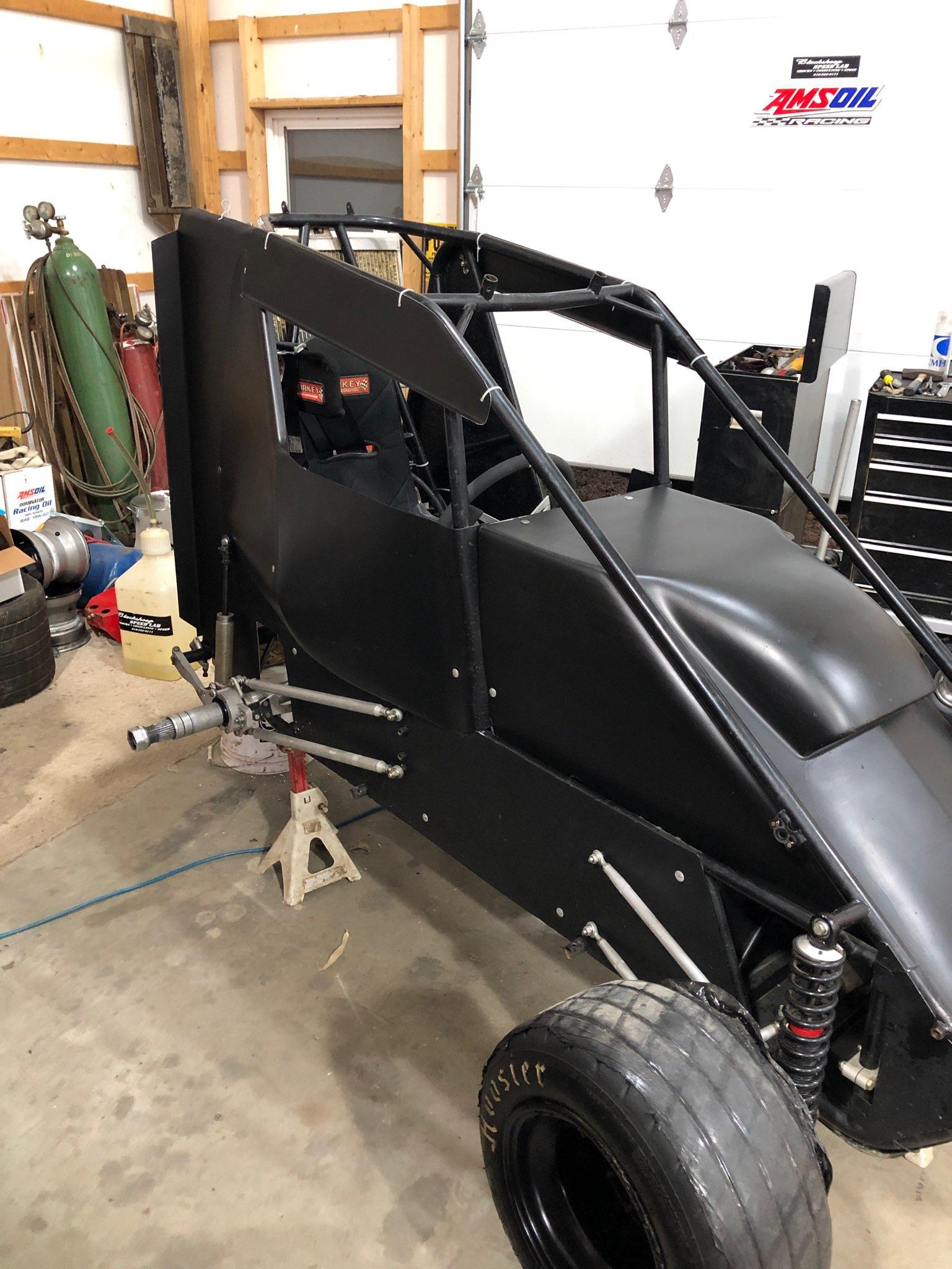

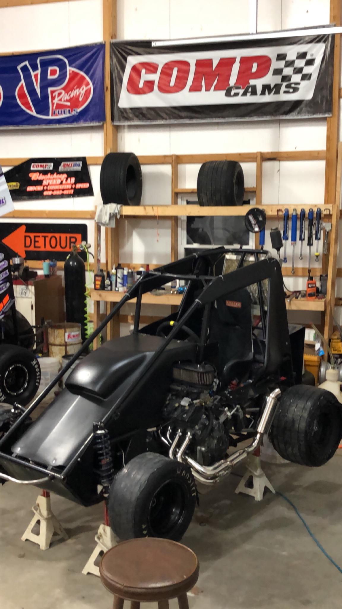

    Needing help. We have owned a printing company for about 8 months now. I've been getting hit up for vehicle wraps. I have a Roland 54" print cut. Long story short I have a local racer needing his Micro-sprint wrapped. Where do I find templates/designs for these kind of applications. I use CorelDraw for designing. Also need a Good inexpensive (62") laminator. micro sprint 2.jpeg micro sprint.jpeg

    I’ve not seen any templates for these myself.
    Take pictures and scale them in your design software. From there you can create your own template or just design on top of the images

    Ron is on target with using pictures to create your own template for a unique wrap like this one. We like to put a something on the vehicle to scale against like a yard stick or simply a piece of copy paper. This gives us a constant size reference for every side. Make sure the photos are taken straight on from a distance with space showing on all sides to get a flat image.
    This wrap has some complex geometry on the hood that will create a lot of challenges. Make your design with plenty of bleed and good margins. Since you’re new to this area you may want to consider printing the background design by itself and add decals for the details that have critical placement. Finding out the vehicle curvature warps text or makes it trail off the vehicle can be an expensive learning experience.
    We bought a Kala Mistral laminator about 8 months ago and love it. New around $10-12k. It’s easy to set up and runs full rolls straight and fast. There are less expensive ones out there but this is the one I have experience using. We laminate for a lot of nearby sign companies, you might be able to find a nearby company that will laminate for you out until you purchase one.

    Yes, you will need to create and scale your own template.
    Make sure you charge enough for this, there are plenty of curves/angles and the time needed to disassemble the frame for application
    also, make sure that you test the surface adhesive.
    When we have done wraps on these time of vehicles they have plastic surfaces that regular material will not stick to.

    Looks like it can be done in five - correction - six pieces. You can do what the Pro MX graphic guys do - lay down clear laminate, trace a 1/2 in inside all the edges - digitize and there is your template. Cut some cheap calendared vinyl and see how it fits up / make adjustments.
    Also as mentioned above- if this is plastic or carbon fiber- use Convex or Substance vinyl for high energy surfaces.

    i think that hood cant be done in one peace. That bumb must be done seperate.
    if customer is serious, and want 100% product, then you have to make templates by yourself. If not, than make some desing where joints wont be so visible, and then print some sheets and wrap that car.
    for serious template:
    I use pvc transfer paper. I "wrap" all the surface, that supposed to be wraped, then draw lines with marker. Then i lay transfer on some waste backing paper, put it in scanner, and draw lines in corel/illustrator. It is very helpful if you have roller scanner. Because if you take picture image isnt straight...

    My advice, don't wrap the whole thing. Nobody does that on these cars. It is a waste of yours and their time.
    Do panels for the sides and wing, then a contour cut number for the hood and top of wing, and a contour cut sponsor for ontop the hood scoop.
    Use this template you need something to use for presentation purposes. https://dirtracingapparel.com/product/lightning-sprint-template/
    Take your own measurements for the finished thing.
