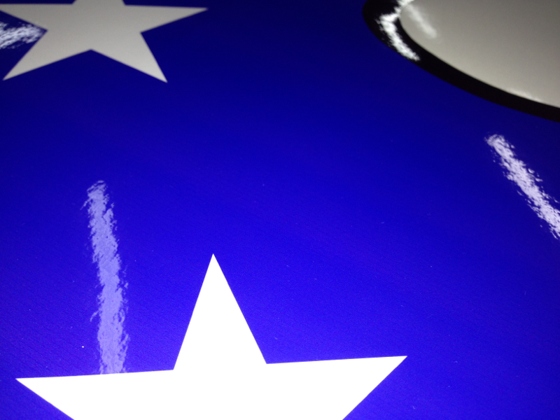

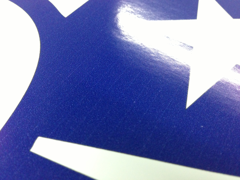

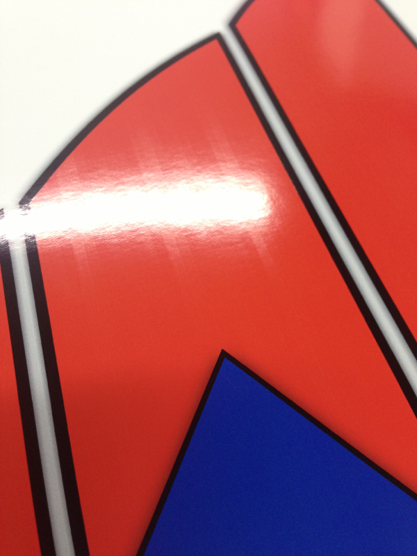

Heres some pics, first one is a 540x720 profile from hexis, second pic is ij180cv3 almost no lines. And third is an avery profile. (Weird lines)

Ironchef, these banding lines are they typical for Mimaki printers? I have heard Roland doesn't have these problems, just asking. I am new this and a bit disappointed. I received samples off a Epson S30670 and they look perfect.

I have installed and run about 10 of the CJV30 printers and have been able to dial all of them in to print solid colors perfectly.
If you can't get an even media comp adjustment print the problem is 100% a mechanical misalignment. You will need to do a head slant adjustment to bring the head into alignment with the platen. Once you can get a media comp adjustment print to be exactly the same on both sides of the media your problem should go away. Also in the picture it doesn't look like the media is absorbing ink as well as it should. If you have tried different profiles and heat settings I would try Oracal 3641 for sure. It's a good price and quality vinyl.
JJPrint
VanerJ, does it take a tech to adjust the slant?
I was running 3641 and was not able to print a good comp line. I did run a comp line on the Hexis material (4 mil) and printed an even comp line. I have noticed that the left side of the machine runs 3 deg C cooler. Mimaki USA says no big deal.
Solventinkjet
DIY Printer Fixing Guide
It will take a loupe to be able to see the pattern that prints out. You can look up the process in the tech manual. It is worth a try to do it yourself but if you can't get it just right you can call a tech. It involves loosening the head cams and using the adjusting mechanism to bring the head into alignment.
You should be able to get a perfect comp adjust on all types of material. Depending on the age of the machine you could also be having print feed problems that are skewing the media and causing the problem.
