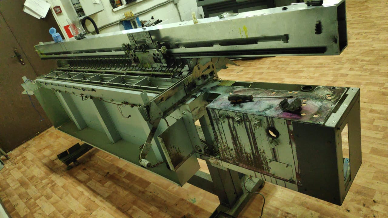

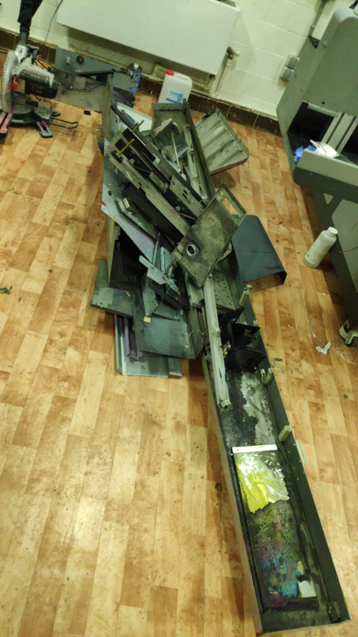

The new project begins... 4x XP600 heads

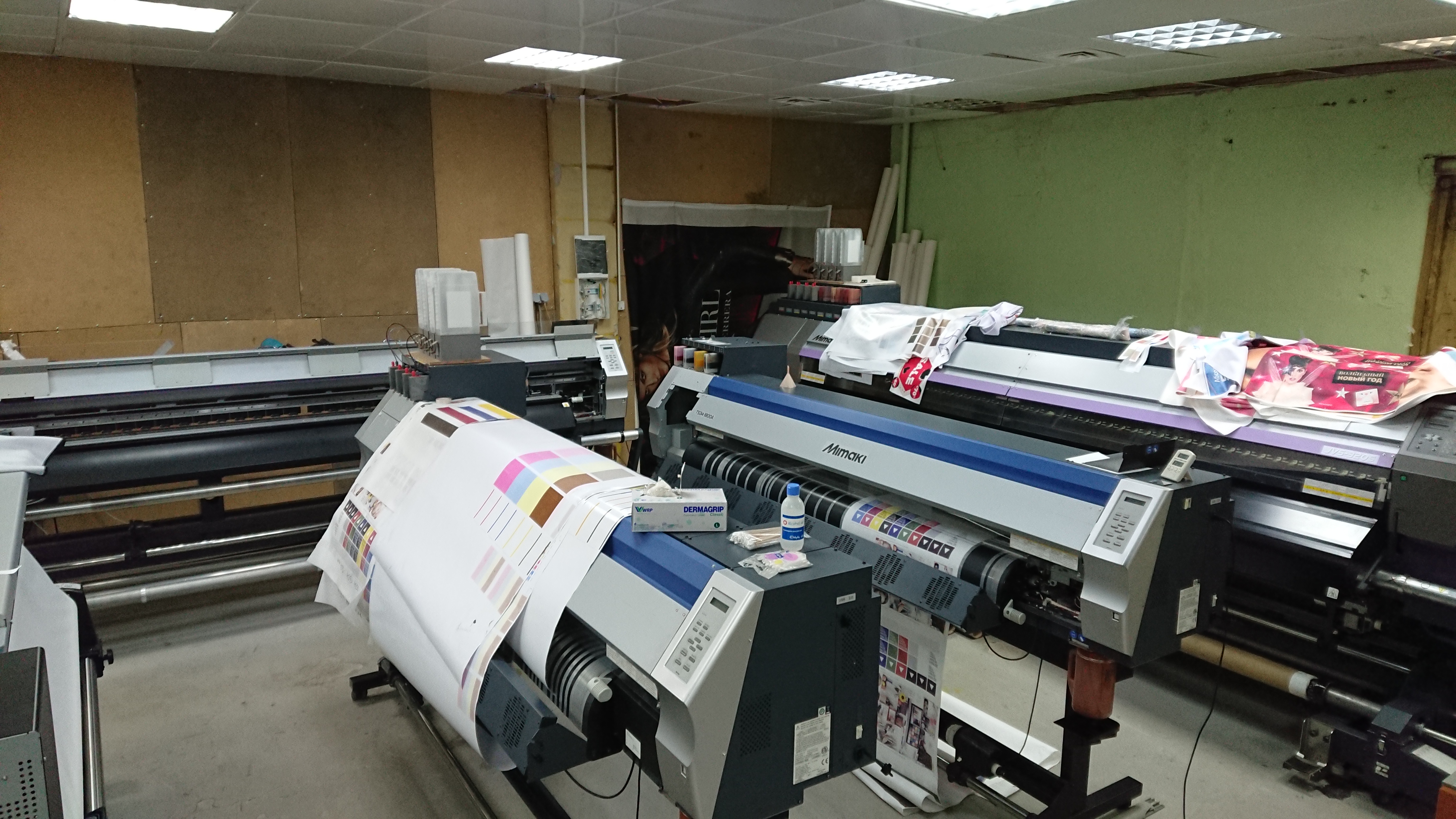

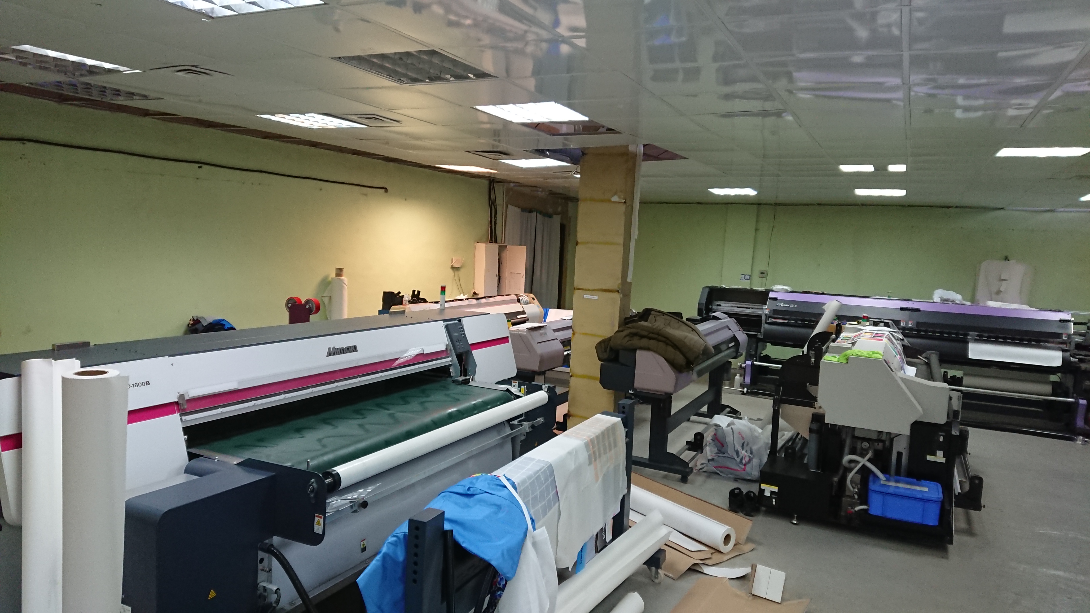

You might would love to know what's gonna be next... Here you go!
JV5-320, JV33-260, two of JV34-160, TX400-1800B, two of JV4-180 and one Chinese UV flatbed... Who knows, what else :)
If anyone interested - don't hesitate to contact me)))
