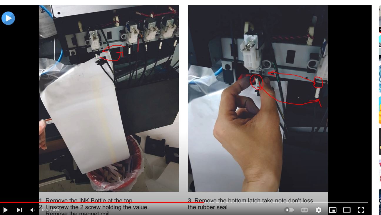

hi,
did you try to swap the 7 and 8 connector to see to try isolate where the problem is by doing so u can aleast exclude the good working parts and potion. this can easily be done without the mimaki tech personal help. u check my youtube video. My problem fix as the value is weak leaking. But since you have change it not really sure so u try swap the connector see if your still having the Overflow in the same 7 or did it migrated to 8.
