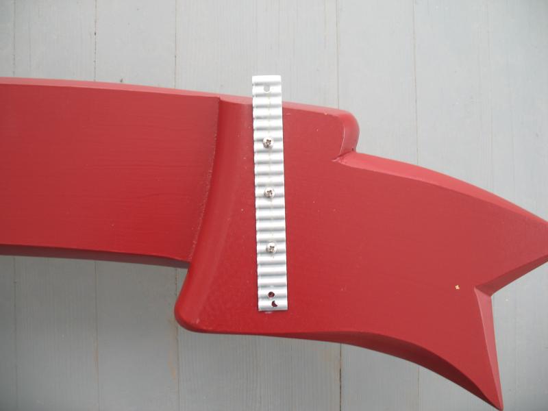

I make mostly small to mid size house and property markers. I usually have key-hole slots for a "blind" mount. For odd (trees, fences etc.), or in this case a long sign, I use galvanized brick straps. They are attached with 1 1/2" stainless steel screws.

How well does the galvanized hold up? Does it rust on the ends (from using snips to cut it to length)?
